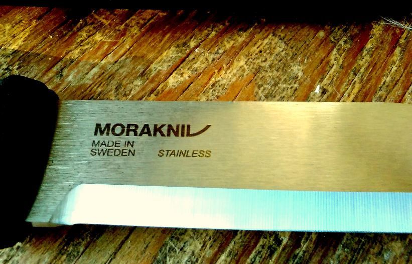

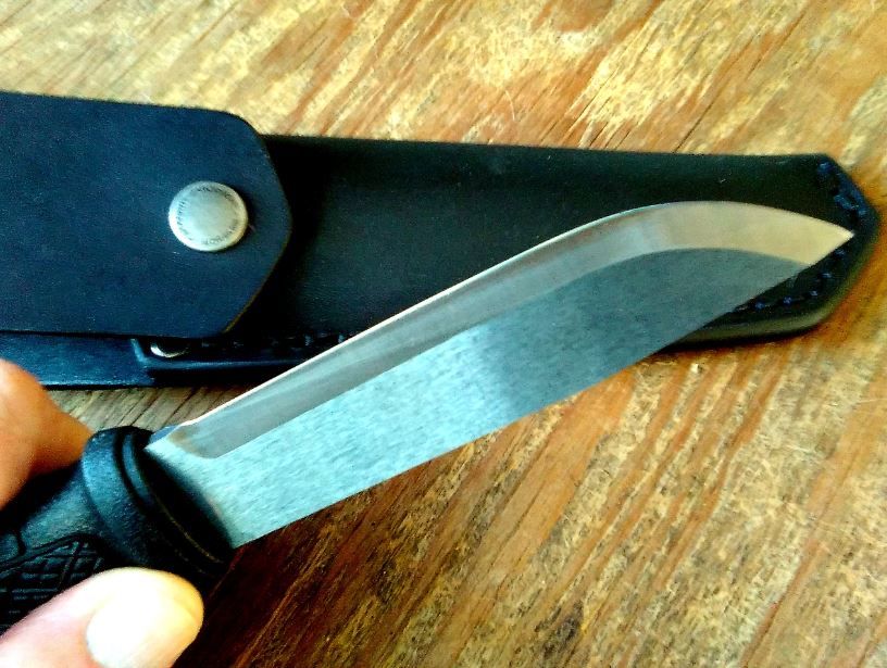

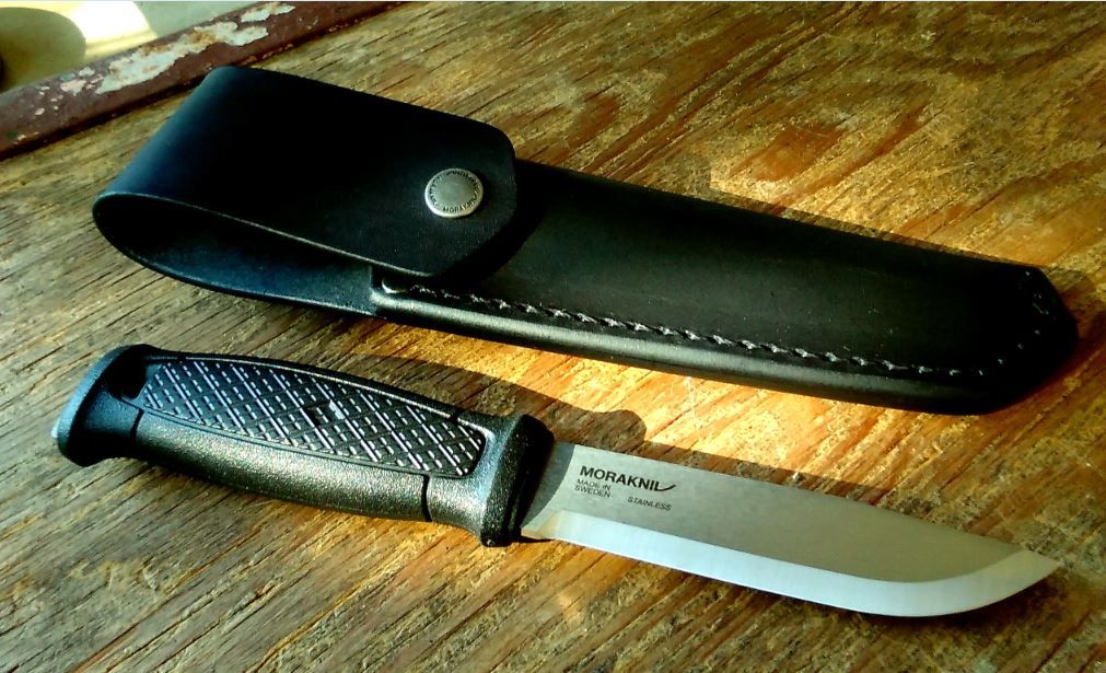

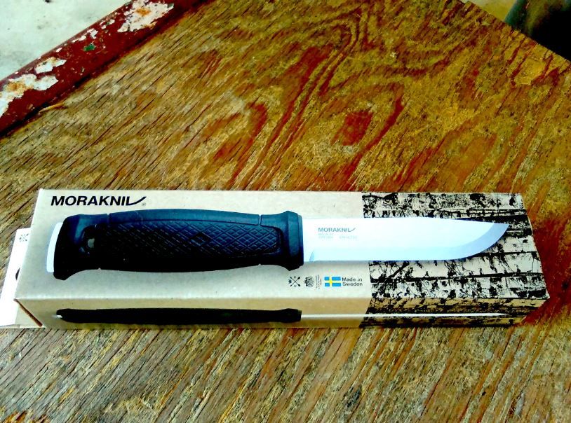

First shots....
Beautiful sleek lines and flawless grinds/finish...
Feels awesome in the hand, solid....this ain't your daddy's Mora! Has the same kind of edge my Bushcraft Black did...a tiny microbevel.
I'm really impressed over this knife. Both knife and sheath are absolutely perfect...not a visible flaw anywhere. Hope to get an edge on it this week and cut some stuff with it, as soon as the new wears off....:D
I'll post up some more pix as I take them.

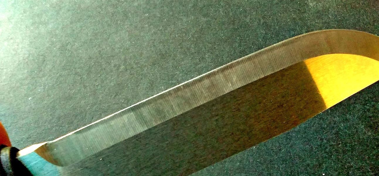

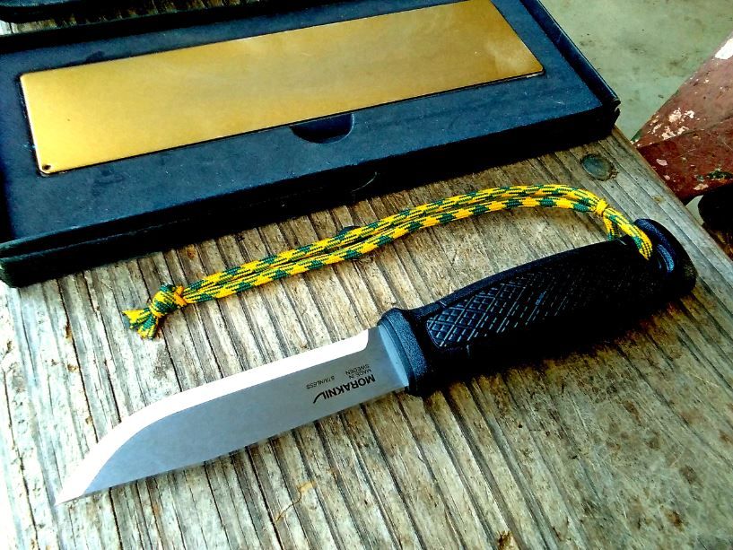

Time for the Garberg to get it's edge prepared. I'll be using a Fallkniven DC-521 to put a nice micro (secondary) bevel on it.

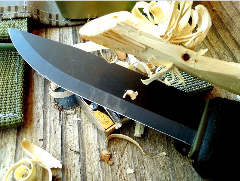

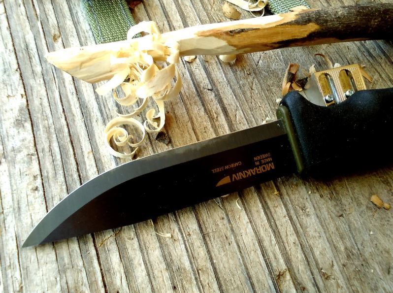

BTW, Been reading about some Moras (esp. Bushcraft Blacks) with edge deformation/chipping. My Moras always get a secondary bevel so I've never had any trouble. To be sure, the B Blk was tested on a dry, hard pecan stick a couple days ago and it easily passed. Did deep cuts with all my weight behind them. Pecan is extremely hard, just slightly less hard than hickory.
"Pecan has slightly lower strength values than some of the other species of Hickory, but it is still among the hardest and strongest of woods native to the United States."
http://www.wood-database.com/lumber-identification/hardwoods/pecan/
The B Blk did fine...

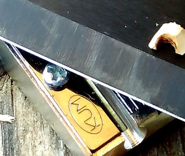

Through the knot.

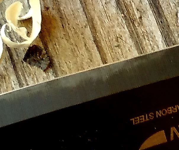

I couldn't see or feel any edge damage, even after pushing through the knot. It would still slice the skin on my thumb which is one way I test sharpness. Not a razor like the rest of the blade but still sharp.

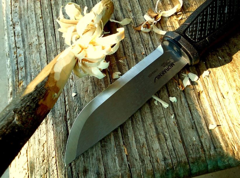

Now lets see if Garberg will roll/chip on the Pecan stick. Since this test was done earlier on the same stick using the Bushcraft Black, I flipped it over, started higher on the stick and put my (considerable) weight into some cuts and chips. It worked great, just like the Bushcraft Black.
No edge damage. It's still perfect and it will still slice skin on my thumb (just like the B Blk).
So, the Garberg's 14C28N Sandvik stainless worked as well as the Bushcraft Black's carbon steel blade doing a similar basic task on the same test medium with a similar edge bevel.
Admittedly, this was a simple, easy test but with what's been posted on the net about B Blks edges roiling during light duty stuff like food prep and other stainless Moras chipping/deforming on tasks like wood carving, I had to test these two. My Moras will probably never have to baton through a log for kindling, but just in case the opportunity for some rigorous food prep or a maybe walking stick or two is called for, they're ready. :D
