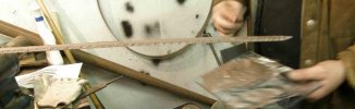

Last weekend was the Gary House Big Sword Invitational, and we had a blast. Too much fun to not share it with my friends here on BF. I will try to explain what was going on as I post pics and I hope some of the folks that were there will jump in as they can. We had a Hammer In last year at Gary's place but things got out of hand as there were a lot of people trying to make damascus at the same time as that was about all there was to do . Ya we had some demos and Bill Burke, Gary and myself quenched some swords but we needed a bit more focus this year, so Gary told us that we had to bring a sword to quench or we might not be invited back. well needless to say there was a lot of swords to quench this year. Before the Hammer In started we had a two day Slip Joint class with Mike Vagnino, that was so good and I was so into it that I did not get any pic's of it, but I will post pic's of my slip joint when it is completed. There are some good pics of Mike as he stayed for the hammer in, and ya he had a sword quench.

attachment.php
Plain old Bill working the fire about to quench
attachment.php
Plain old bill not so happy as he hears the worst sound ever
attachment.php
Mine worked out a bit better for me
attachment.php
That made Mike Rader Happy Mike brought a nice salt bath to temper the swords in
