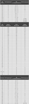

The knivesandtools.com website rates them as similar to a Japanese 3000, 6000 and 8000 grain size.Wicked Edge is now selling 1500, 2200 and 3000 grit diamond stones.
Since some folks have recommended Congress Tools's "Moldmaster" stones for the Edge Pro, I contacted them and asked about their stones. Their response:
Dear Patrick,
Thanks for your inquiry. Approx. micron size for grits follows:
150 grit - 100 micron
240 grit - 60 micron
320 grit - 45 micron
400 grit - 40 micron
600 grit - 30 micron
Our stones are manufactured for industrial applications, so we do not have much knowledge concerning knife sharpening applications. I understand that our stones have been recommended on several blogs and articles, and we have received many orders for our MoldMaster and Ruby stones in the coarser grits for initial rough cut and our FLEX stone in 400 or 600 grit for a finishing stone.
Best regards,
CONGRESS TOOLS, Inc.
Mark Froelick
thank you, sir! I still use it when looking for stones. I noticed that the Edge Pro 400 grit stone is missing now, though. I also noticed that Edge Pro has a crossover chart that doesn't make much sense.I've updated the chart with the EdgePro values, I kind of lost track of this project for... eh.. about three years. Working on catching up again! lol
I want to eventually swap the EP stones out for Shapton Glass or maybe their new diamond ones. I may have to accelerate my plans.I'm honestly not sure, I've always had a challenge pinning down actual values for the EdgePro stones. I keep finding totally different values for them.
True! My Shapton Glass 500 is a great stone. The cost is the biggest hurdle.You're certainly never going to regret going to Shaptons!
