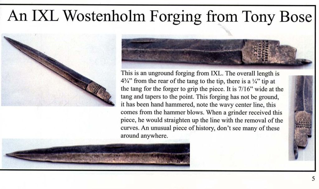

From Tony Bose. Note that the dagger blade is only 7/16" wide at the tang. The old Sheffield bowie is very old and has the original sheath
