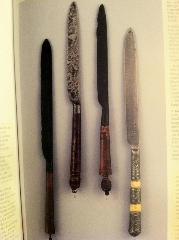

I would love to see someone make some of these knives. It's generally a cutlery book and not much in the way of weaponry. Mostly the knives of every day use. Which I find pretty neat!:D
The bottom left inset picture from left.
Iron, solid bolster(Integral it appears) crudely carved through tang bone handle, but cap missing c. 1590
English. length 23cm
Iron, solid bolster, through tang. The bone handle is engraved with panels of scrolls and floral decoration, and terminates in a turned ball finial inter-spaced with an amber washer. Marked on the blade with an acorn. English c. 1590 length 22cm
Iron, with solid bolster and through tang. The bone handle engraved with dot and circular decoration, secured with a flat brass cap and elongated ball finial. Marked on the blade with a crown and the dagger for the Cutlers' Company of London. c.1590 length 21.5cm
Iron, solid bolster, the iron handle inlaid with scrolling foliate designs using silver and gold wire. It has ivory faceted spacers. Marked on the blade with a heart and the dagger for the Cutlers' Company of England. c. 1590 length 23cm
