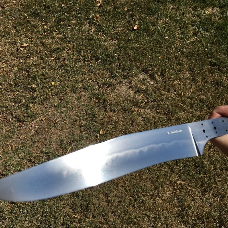

Kuraki, very nice! How are you polishing your blades?
Kwaiken in Hitachi Blue #2.

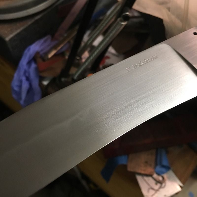

I forgot a Blade overnight in white vinegar. I bet the pearlite etched 1/2 way through the blade.

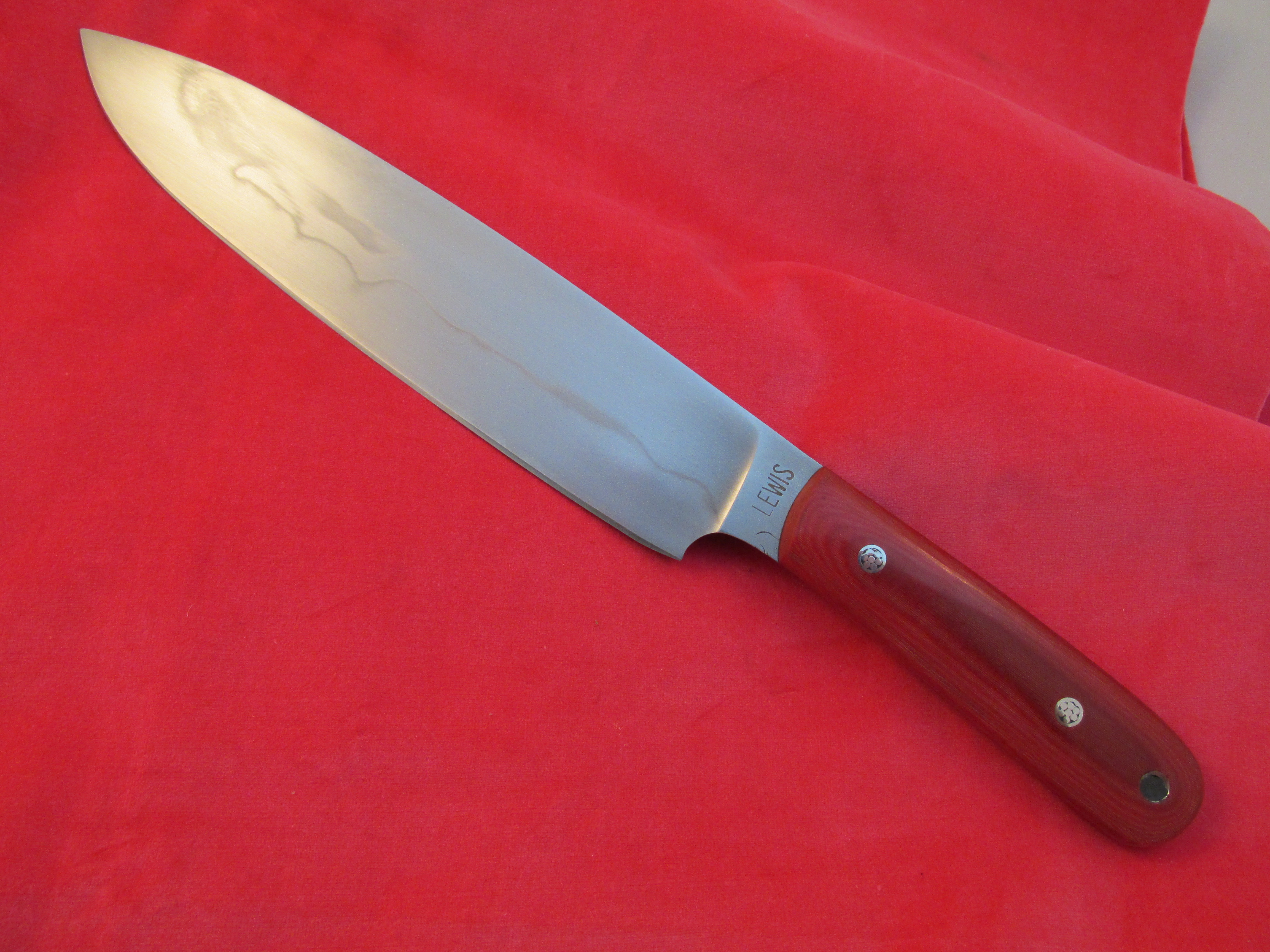

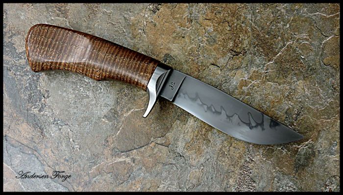

How do you do a clayless hamon?
Hoss

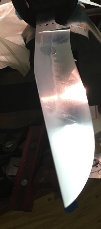

You're polishing away all of the contrast.
I'm not an expert but the pitting is probably from spending way too much time sanding/polishing, if your polishing with water and trying to get more from your hamon by polishing it that will cause tiny pitting like that.
I guess it rust at an almost microscopic level.
I've done the same thing a couple of times.
