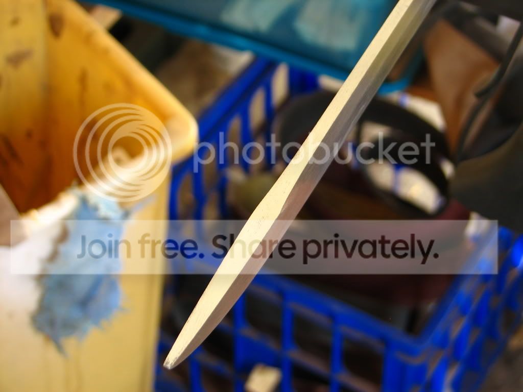

okay... this is mostly venting...
i spent a whole week on this knife.
forged from 7/8" W2 stock... stock removal was with a file
it was beautiful sharp lines, clean profile... big.... orginal design (or as orginal you can get with a traditional knife)
and then... i hardened it last night (after many trials and tribulations with the claying...)
well i got a very active hamon... but it was ugly.. and not uniform at all... so... i put it out and normalized it twice that same night...
came back the next morning... and it had all these stress fractures...
i wanted to hit something...did this little dance thingy...NOT FROM JOY
okay... am i too attatched? i mean... i got a heap of expericence... but it hurts not to get the pay off even if i were to pay someone to take the knife.. the finished product is the payoff... maybe i am going soft.

I can't really see what you mean in those pics. Are the cracks small enough to be ground out?
the cracks arent in those pics... but they were in the tip... so i cut the tip off... and am reworking the blade as bet i can... it isnt nearly as pretty though. i checked to see if i could grind them out... but no...

Water quenching for hamon is risky. Many swordsmiths have a 50% fail rate. Also , when normalizing, keep the temperature controlled. Same for the quench. It has to be at the right temp, not just very hot. Too hot does a lot of damage. Also, you won't see the hamon until you sand down and etch the blade. What you see right out of the quench is the different decarb layers and coloration of the different steel structures. After quench, I give it one temper, sand the blade to 400 quickly (not a perfect job) and give the blade a quick etch in FC. That will show a lot of the character of the hamon. If it is OK then go back and do the second temper, and finish the blade to the finer grits required to see the detail in the hamon.Etching as you go to see the progress.

How hot are you getting these blades before you quench? You should be around 1400f to 1425f for water. A blade at this temp doesn't look hot enough to harden but it will.

Bladesmith, what you said is exactly what i did... i took it out and tempered it right away. then quickly took it to 400, etched with FC and didnt like what i saw... so normalized again. then the cracks were there next morning. rats

sadly what is left of the blade isnt in any of the pictures. i had to cut it off right where the back starts to become a uniform width. i just dont hae the heart to finish it quite yet. workin on a 1095 knife with water quench...
