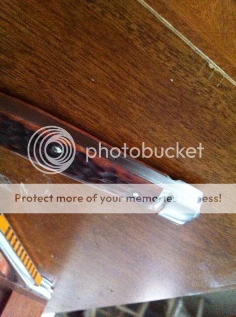

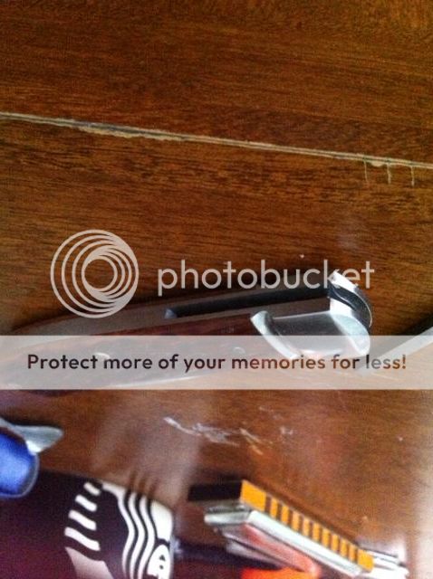

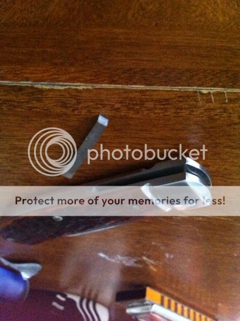

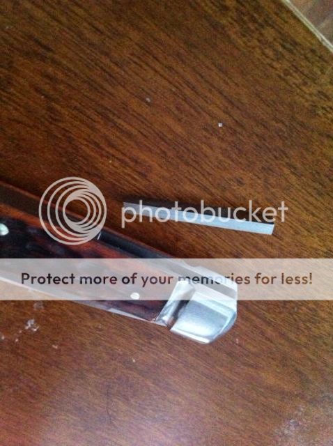

First off let me say that it is not my intention to be negative towards Case. The purpose of this thread is to show people what happened, because this has never happened to me. I have not contacted case because i'm still at work as I type this post. I'm curious if anything like this has happened to a fellow BF member....
I was doing a mundane task, cutting the tape to flatten a box and it went off without a problem.... when I went to close the knife in question which is a Case/bose tribal spear in chestnut bone which I have owned and VERY lightly used for about 3 weeks...... I heard a "ping" and when I looked down the top inch or so of the backspring had broken!!
A crisp break, It looks to be a heat treat problem perhaps. I am going to contact Case, but i'm not sure what they can or will do. anyway... on to the depressing pictures.... I would like to add that I got it from a reputable dealer and it was sold as new and mint.
Eric, that's terrible. This (unfortunately) has only happened to me years ago with a vintage "Springer" switchblade. They were actually very high quality knives and had a traditional look to them.
But back on point---you are in very good hands warranty wise (as I think you already know) other then the time it is away from you, I would assume all will be made right :thumbup:
Paul
That is a terrible sight, and as Paul said, I'm sure that you will be well taken care of. At least for Case's part I hope so.
Ouch. Even before I read your post I knew this wasn't going to be good when I saw those pics. Definitely send it back to Case, otherwise all you have there is a very expensive paperweight.
- Christian
It looks like a heat treat problem to me. Don't ask me how I know but it can happen to anyone. I am sure that they will make it right though.
Gene

Yeah this just happens. I personally think that it must be some kind of inclusion defect. I guess heat treatment could cause it to be brittle, but I am thinking that's a pretty big miss on the HT.
I had a weird one on a steel warrior lockback whittler. On close, one of the small blades just went soft. I opened and closed it to be sure what i was feeling, then flipped it over and the spring was curved funny. I did something to it, I forget what, and that half of the spring then just broke off. I guess it cracked on the inside, not all the way through, and then snapped through after some fiddling.
Yeppers, as said either bad heat treat or just a bum piece of steel with either an inclusion or void in it. Quite sure Case will take good care of you ;-) Total bummer it happened tho!
