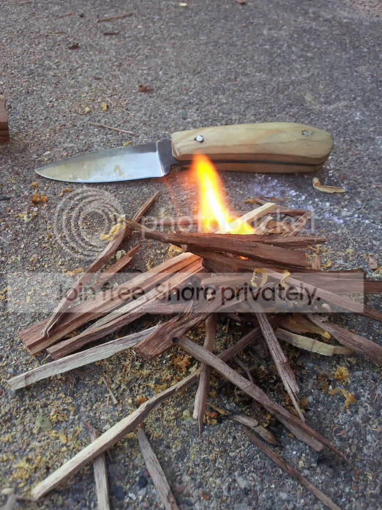

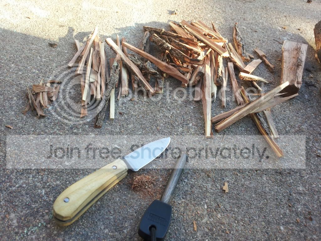

First, we have the "one stick fire"
Ok, so when Shane suggested this, I had to look it up on youtube and found out that it is a challenge to make a fire using nothing but a knife, firesteel, and one stick batoned into several smaller pieces, and then fuzz shaved off for the tender.
Since I didn't have the time to go out to the deer lease, and didn't want to disturb my future dinner, I decided to do this in my back yard with the wood I had on hand that I use for smoking
First up is this piece of Pecan

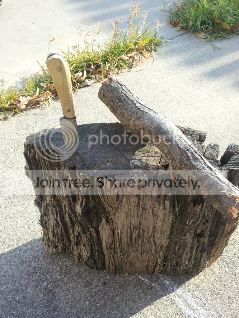

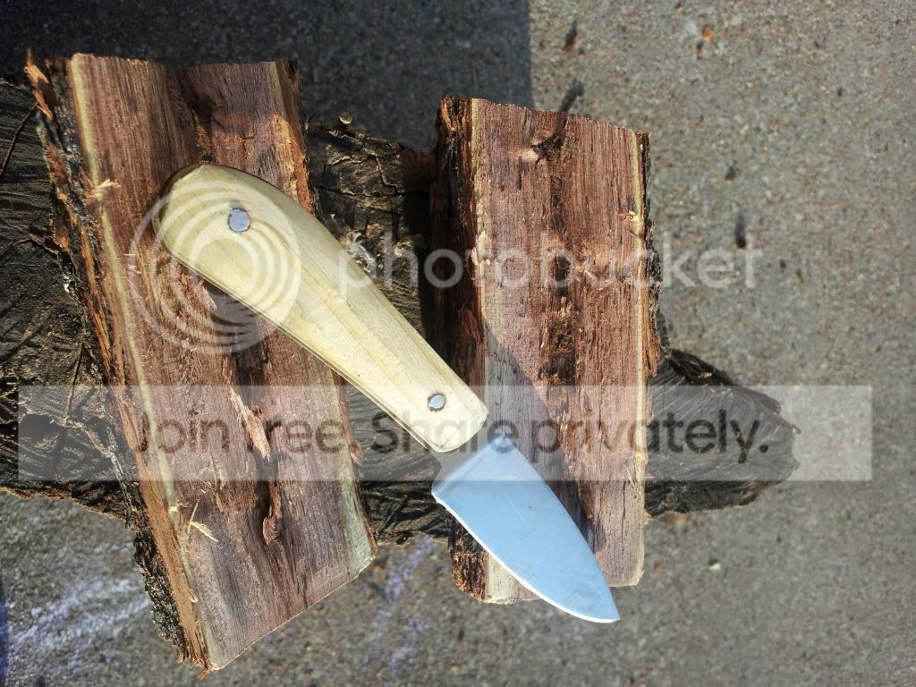

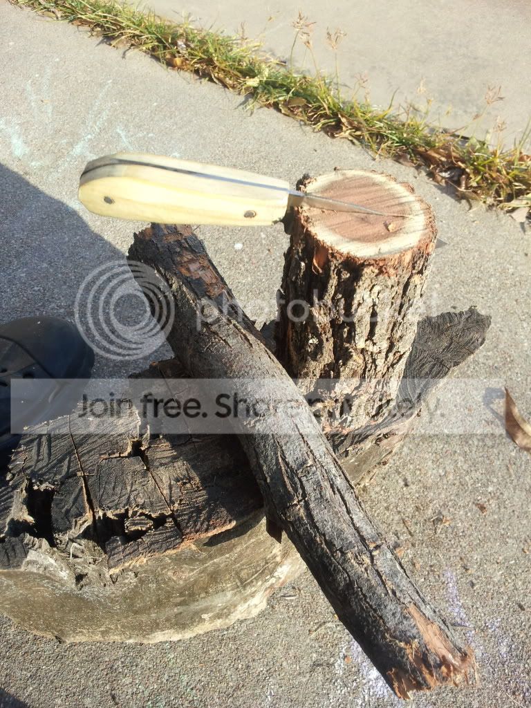

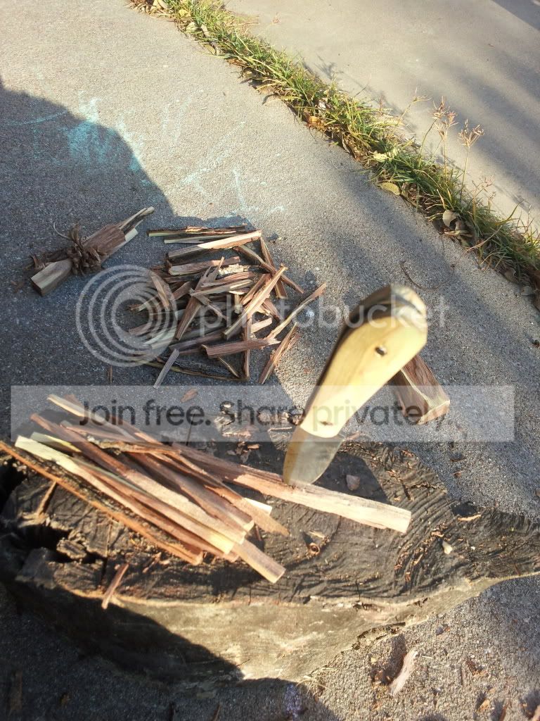

But I took too big of a bite in the wood and had no room to baton, so I chose a smaller piece of Mesquite
The thin knife went through with no problems. Who said you need a camp knife to do camp chores?
I had the wood split in no time. Here I am poking the tip into the small pieces and prying sideways to split. Even though the Mesquite was super tough, it gave little resistance

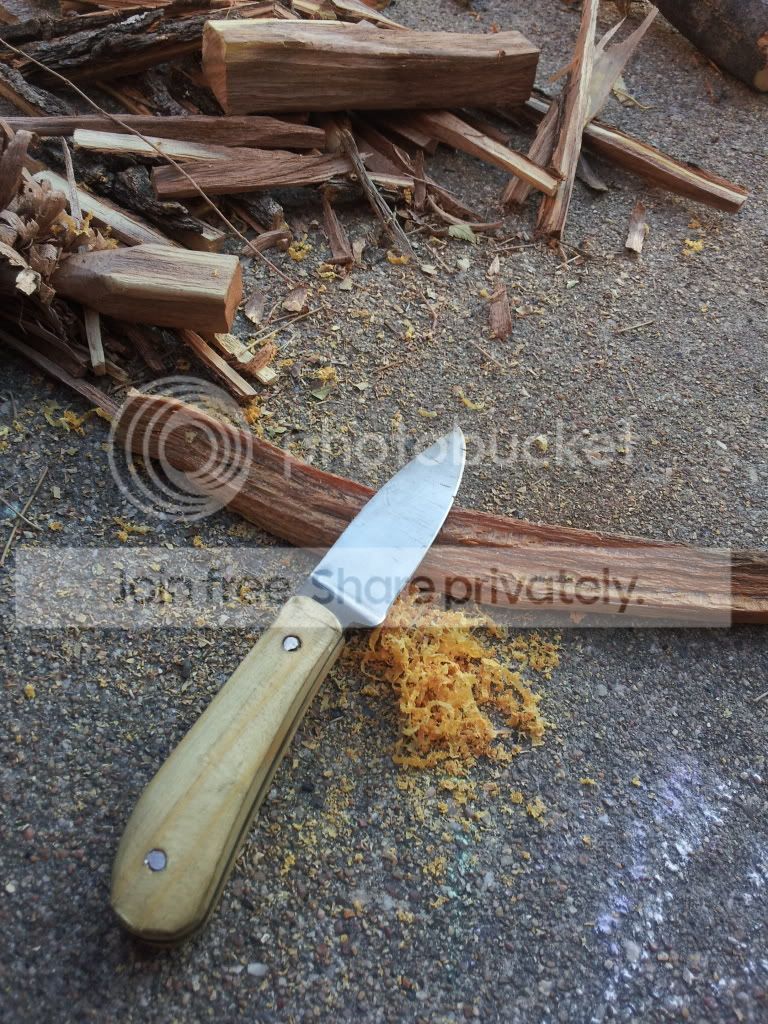

I don't guess I took any pictures of the fuzz sticks but here I have scraped piees of fuzz of for tender and have the firesteel ready
I felt like Tom Hanks "FIRE"
OK, so I call BS on my own thread. The Mesquite shavings would catch but not spread around. Either the wood wasn't dry enough yet or my skills just suck, so I had to use shavings off a piece of "fatwood" - pine stump... OK, so it was a two stick fire, but who's counting. The knife did fine even though the user didn't.
I suppose I could have made this test easy on myself and used pine or other soft wood, but there's more hardwood where I live and Mesquite is tough as nails so I really wanted to put the knife through it's paces.

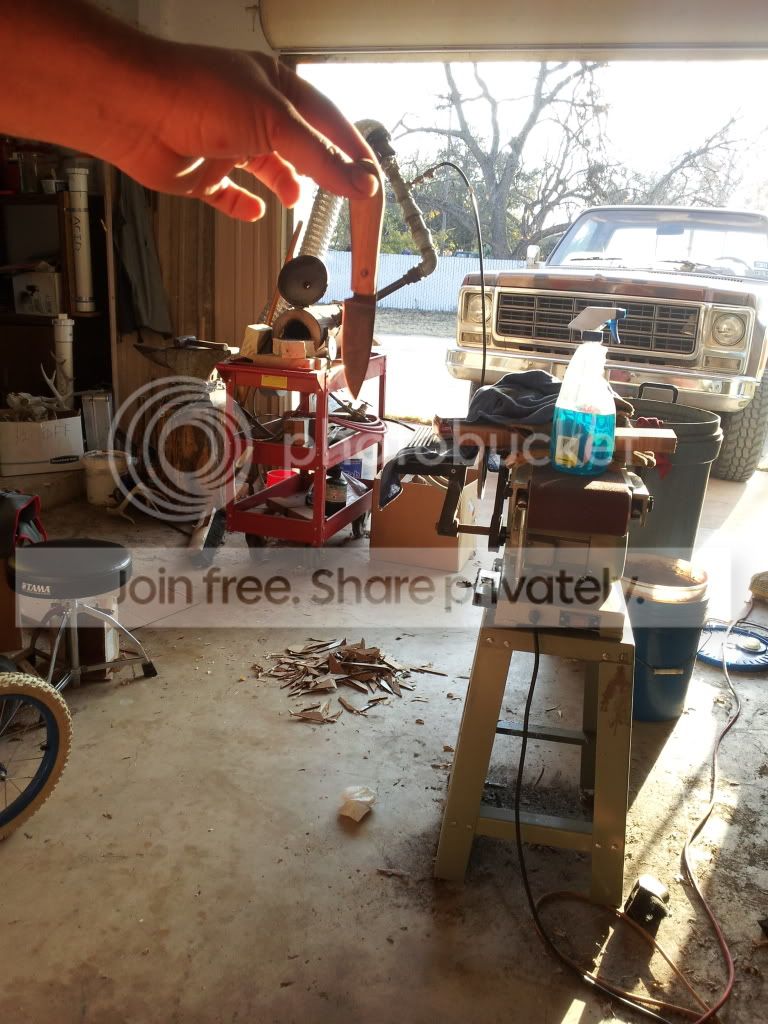

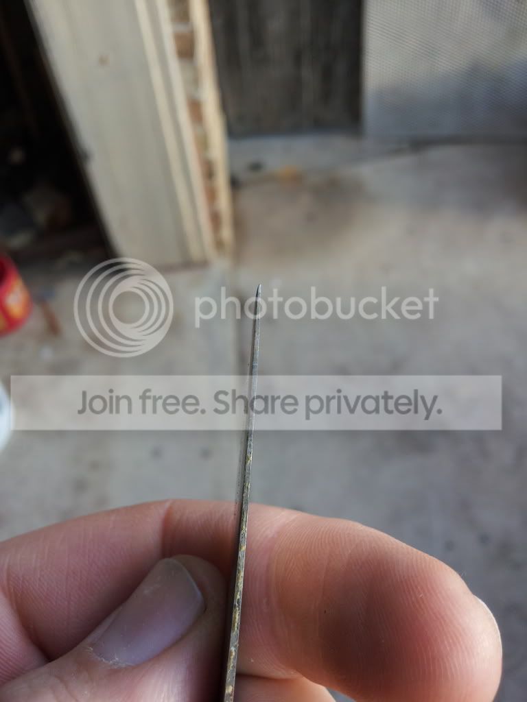

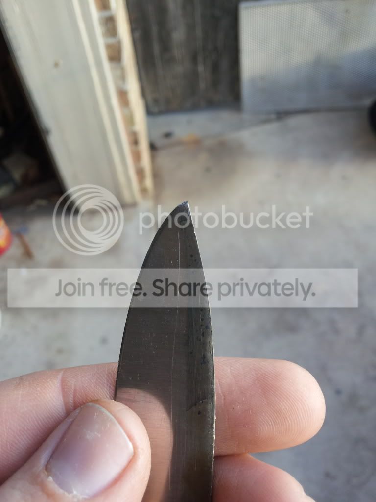

It was suggested that I do the much dreaded drop test on concrete floor. So I measured a distance of 48" and let her fall.
I suppose this is to make sure the tip is tough enough to take a fall and the HT is spot on so that the blade doesn't bend too much or break.
Here are the results: I'm not going to say that it was unharmed b/c there was a tiny bend in the tip, but it didn't break
It looks worse here than it actually is. Remembe the bent blade is from prying on the pine. This is just to show the tip.

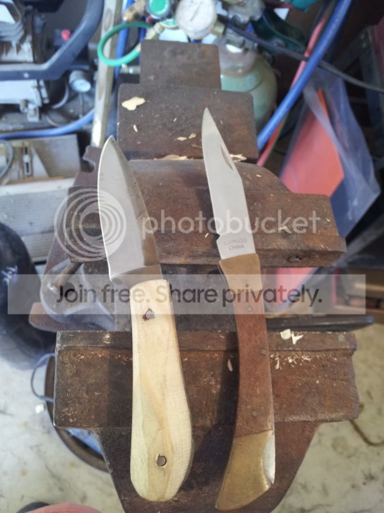

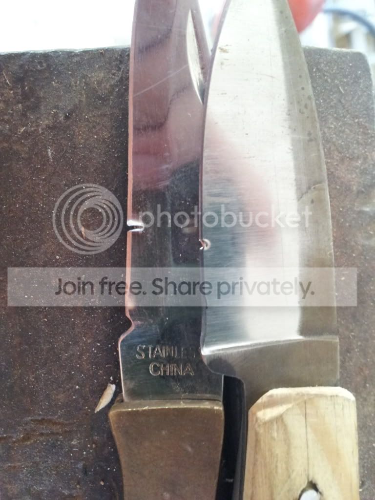

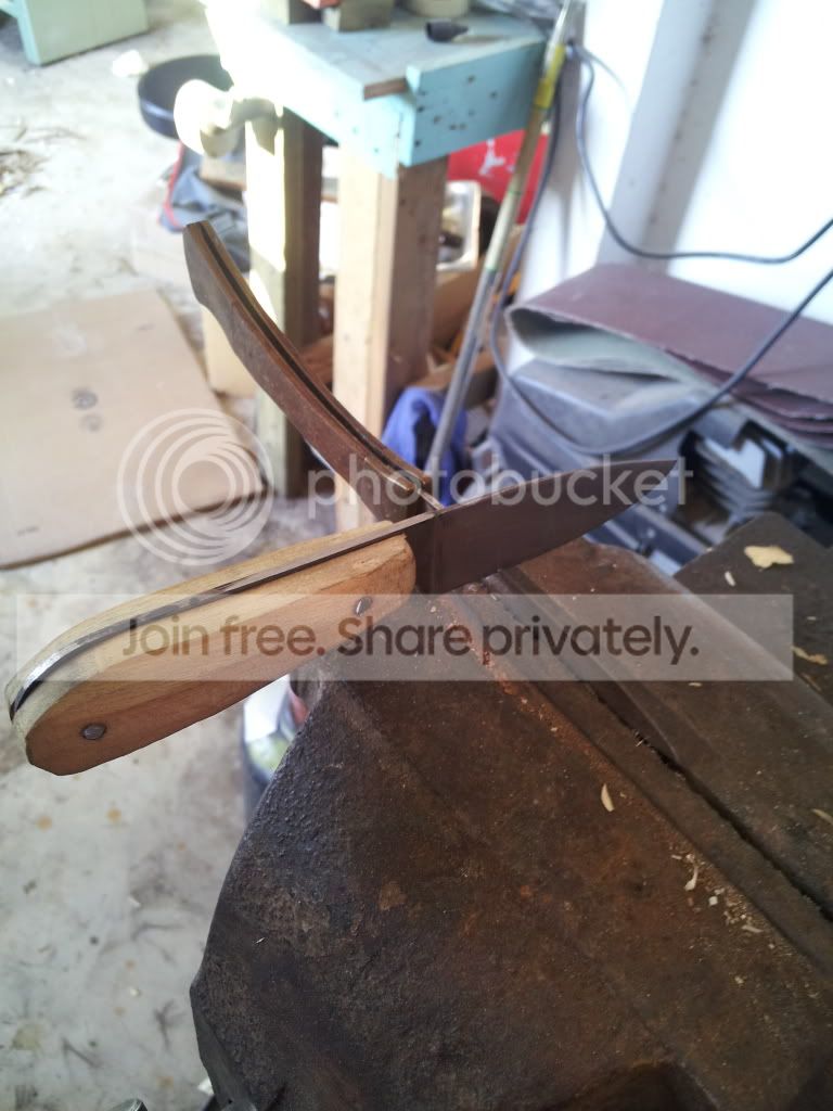

Third (and I've always wanted to do this)
It was suggested that I try to shave mild steel, but I took it a step further.
I can't tell you the number of times I've heard, "Why should I pay more for your knives when I can run down to the gas station and buy a $10 knife". I decided to baton through "440 surgical stainless" or whatever they call it.
This is a knife that I got a long time ago from who knows where. All I know that it says "Stainless China" and is going down
After I tightened the chinese knife in the vise, I put mine on top and have it a few good licks with a 3 pound hammer.
The results?
Sure, mine has a nick in the blade, which I was expecteing, but not nearly as bad as the other one. I imagine I could have gone all the way through it if I really wanted to.

You probably could have convexed that edge and made it fatter and gone right through the China garbage with no nicks. That's an awesome and entertaining test though.
When I suggested the one stick fire you could have chosen one stick of fatwood lol! Good job and yes you need to scrape a larger pile of fine shavings. Hold the blade like a cabinet scraper and get after it. Still I was impressed with the job you did bro. Awesome job on the heat treat and being open about the findings
