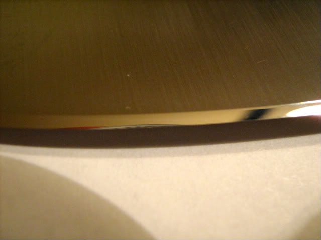

I was not completely happy with my sharpen job, so I went back to the UF ceramic and worked the edge for a while and then re-stropped. Its real sharp now, at or above sharpness of the 52100 mule, the edge is now so mirror like it hard to take pictures. I did the best I could to take a close up but because of the finish It would keep focusing on objects in the reflection.
Sorry no hair in this one, every time I touched the hair it would just cut it.
This is the best close up I could get but there was some unseen dirt on the edge
