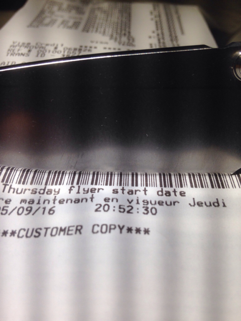

I have no issues with my 25s keeping a mirror polish with a weekly stroping. Yes even on S35VN.
