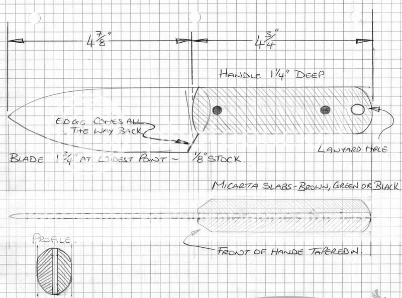

The Booshway is still very close to a perfect do-it-all knife for me but I've realised I do more cutting than chopping so came up with a slightly smaller, thinner design that looks like this, time will tell if this proves to be my perfect one knife design or not !

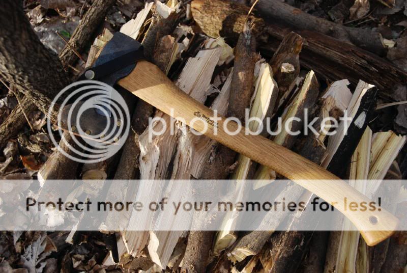

For wilderness skills/primitive survival, a knife may or may not be the best choice.
If I have to survive through the night, especially in need of fire and shelter, something like this would rank far above a knife:
