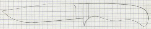

Some time ago I decided to pull together all the elements I appreciate in a full-size hunter. I listed the aspects of each part of the knife that are important to me after fifty years of field dressing and butchering hundreds of animals from javelina up to elk size. Once I completed the list and managed a sketch, I realized I'd never owned a knife that incorporated all these features, so I decided to ask a few of the top makers in the country if they would consider building it for me. Below is a copy of my sketch and photos of resulting pieces from three master smiths.
I thought the design might serve as a basis for interesting discussion here, so I'm offering it for your consideration and certainly all views are welcome.
Thoughts on Size:
I typically carry a 3-4" blade folder for small game and utility purposes, but a 5-6" fixed blade hunter is my preferred knife around camp and on large game. I'm a native Texan and still hunt there often, and Texas once had a legal limit of 5.5" blade length for belt-carry knives. I find this length serves me well. That and my other size/use preferences have resulted in the following dimensions:
Overall Length: 10 inches
Blade Length: 5 ½ inches from guard face to point
Handle: 4 ½ inches, including guard
Blade Thickness: 3/16" at ricasso with distal taper to point
Sketch:
NOTE: Edge starts away from the ricasso at a DOWNWARD angle from centerline to a deep belly. Top of spine is clean and straight out to a swedged clip (straight clip, not dished), the clip running half the length of the blade.
Thoughts on Design:
1. The way the edge line starts from the face of the guard at a downward angle does two things: a) it helps hold material on the edge in a pull-cut much like a recurve does but keeps the edge in line for straightforward sharpening; and b) it develops a deep belly, well-positioned for skinning. The straight ricasso, in-line with the edge (no choil), allows the blade to slide all the way in and be drawn back out without snagging. There is enough ricasso behind the edge to support a finger when choking up on the blade.
2. The clip also does two things: a) the combination of the length of the clip, starting about midway between hilt and point, together with the clip angle, forms a fine working point positioned well for penetration. On a larger hunting blade like this, I appreciate a fine
point when working around joints and in tight places; and b) the clip is straight rather than dished, so it can be laid flat against a hide to precisely guide the start of a skinning cut.
3. Neither the spine nor the top of the handle rises above the top line of the knife. This is primarily a cosmetic thing with me, but is also a positioning function. I prefer knives that don't "break back" at an angle between spine and handle, with neither the line of the spine nor the top line of the handle rising up from level. I appreciate a design with the top line of the handle in line with the spine, then dropping away at the butt.
4. The contours of the handle achieve several things: a) the rounded butt is comfortable when tucked into the center of the palm, so that the index finger can be laid along the top of the handle for controlled point-work/penetration as when taking out back straps; b) the rounded butt is also comfortable to strike with the palm, to start the point into resistant materials; c) the contouring along the bottom of the handle allows good control, security and comfort in all positions, including pull-cuts with the handle upside down; and d) the "bird's beak" at the butt gives something to pull against to free the knife if the blade binds in something.
5. Finally, I really appreciate a radiused spine and also a radiused underside to the ricasso, for comfort when choking up on the blade.

I really like your design - and how cool it is to have three top makers render their interpretation. They are all terrific. Did you specify blade steel / handle material / embellishments for each, or just let the makers have at it? Are you getting any more made? Have you had a chance to use any of them yet? If so, how did the various aspects of your design play out in use?

First IMHO you really got the tip right. Most guys bring the tip up for my taste way to much. I understand that they are making a knife not to pokey for skinning purposes but incisions have to start somewhere and a lower tip for me helps with the detail work of capeing. I skin with the belly of a blade and you did that nicely. Not to much but enough.
Great comfortable shaped handles
All are nice but I love the Knight

Thanks for sharing, Will. Good ideas on a design and well executed by all the smiths. My only preference would be for a stouter tip but these turned out just fine. :thumbup:
