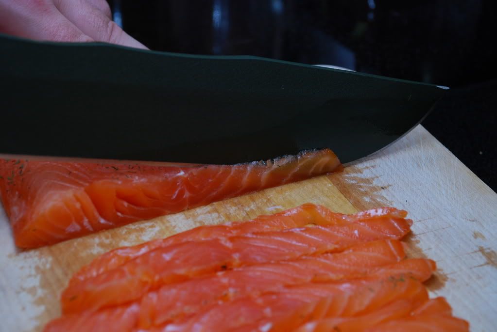

Why all the hate on the fatty....if you need to fillet a fish.....I bet it would work...not as good as a fillet knife, but work nonetheless. It is the edge that cuts, the thickness just separates.....
BRING THE FATNESS!!!!
What he said!! :thumbup:
Fatties can slice:
I am a big fan of the thinner blades, I personally feel 3/16" is the optimum for a knife this size and 1/4" on anything bigger.
well.............you can wedge things apart with a thick edge....
but it still doesn't SLICE as easily as a truly thin kitchen knife.
I like'em THIN. It would be very difficult to break a ASH1 in 3/16 with bare hands let alone .320. There is only so much leverage you can generate from a knife that length.
I will still be getting a CGASH1 because I want to see if I can get a better chopper out of it by tapering the tang and moving the weight forward.
Most any sharp knife can slice soft material like flesh quite easily because the soft material will just part aside giving very little resistance. If you took a thin knife and a thick knife and did a slicing test on flesh... the performance would be very close. Do the same test on harder material like cardboard, apples, potatoes, etc.... and the thinner knife will easily pull ahead. Trying it on plastic tubing and the results will be night and day and the thick knife will be left in the dust.
