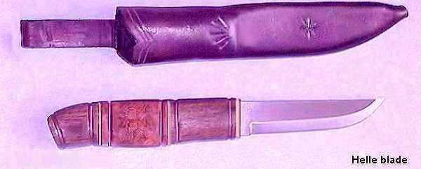

Nice looking knife!Here is the finished result of putting a handle on that YP blade blank referenced above.
The handle is comprised of ENGLISH ELM with a band of JATOBA set into a bronze band. I intended to use a solid bronze bolster but as I wrote above the hollows in the tang just behind the shoulders precluded any chance of getting a tight fit without taking the entire bolster to ridiculously thin. I settled for making up the Jatoba (it is a solid hard wood) set into a bronze band. Got the look of a metal bolster but it is really just a collar. This allowed me to fit the jatoba very closely and then fill in the final gap with epoxy. Wasn't happy but it was the best I could do.
New PUUKKO
CLOSE up of the Jatoba fit to the blade.
Handle detail ~ Unconventional approach but what do I know, I'm a woodworker not a knife maker.
I carved out for the tang into the 2 halves before I glued them together. When cut to length the tang slid in with minimal adjustment.
Here is the block ~
Collar detail - pre assembly. After the fact I'm still trying to decide if a bright shiny bronze collar is better than the forced patina version. I might do a rework.
I like the feel of this knife and the blade (if not the tang) is very good.
