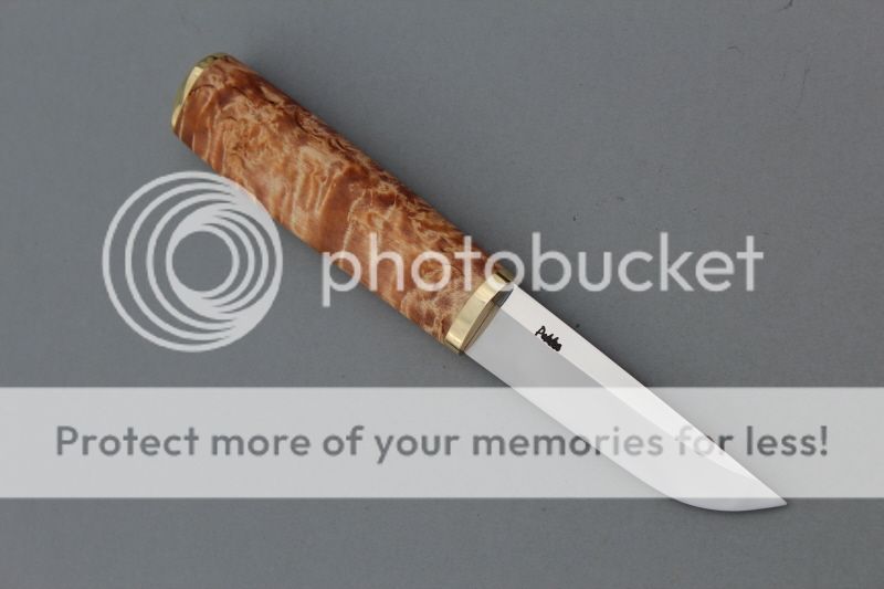

Roselli UHC Carpenter's. A true blue classic and my go-to puukko. Sharpest knife I own. I woodburned a bear paw print into the butt of it in efforts to make it not so plain-Jane.
