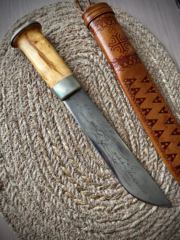

Bought this old Marttiini Lapinleuku from rompetori, a sort of huge open space flea market event held every summer. Would A Arathol know the age and if it's some sort of "special edition" (referring to the sheath)?
I gave some leather balm for the sheath that is otherwise in good condition. The blade is also in very nice condition but probably needs some sharpening. I will use it lightly, most probably for our cooking events.

That blade looks like its engraved rather that etched right? Marttiini stopped doing the deep engraved blades years ago, late 1970s maybe according to the people I talked to at Marttiini. Other than that, it looks like a older model, probably 60s or early 70s. Marttiini used a number of different sheath stamping over the years. Try asking at shop@marttiini.fi, they are usually pretty helpful.
The blade also looks to be more or less convex unlike newer models from the 1990s onwards . It should sharpen up easily using varying grades of fine emery paper on a mousepad or a piece of leather, stropping like you would a straight razor.

Thanks! Yes, it's deep engraved and convex that were giveaways for the older production time. I'll send some mail to Marttiini!

Got a reply from Marttiini. One of their experienced worker was on summer vacation, hence the delayed reply. He stated that the sheath model is from 1960's. Blade is polished and it gives an impression of stainless steel but it is actually carbon steel (makes sense since there's slight patina at one part of the blade, although the blade is very very well kept!). Likely a model 260, no longer in production. No knowledge on the sheath pattern or what it means.
