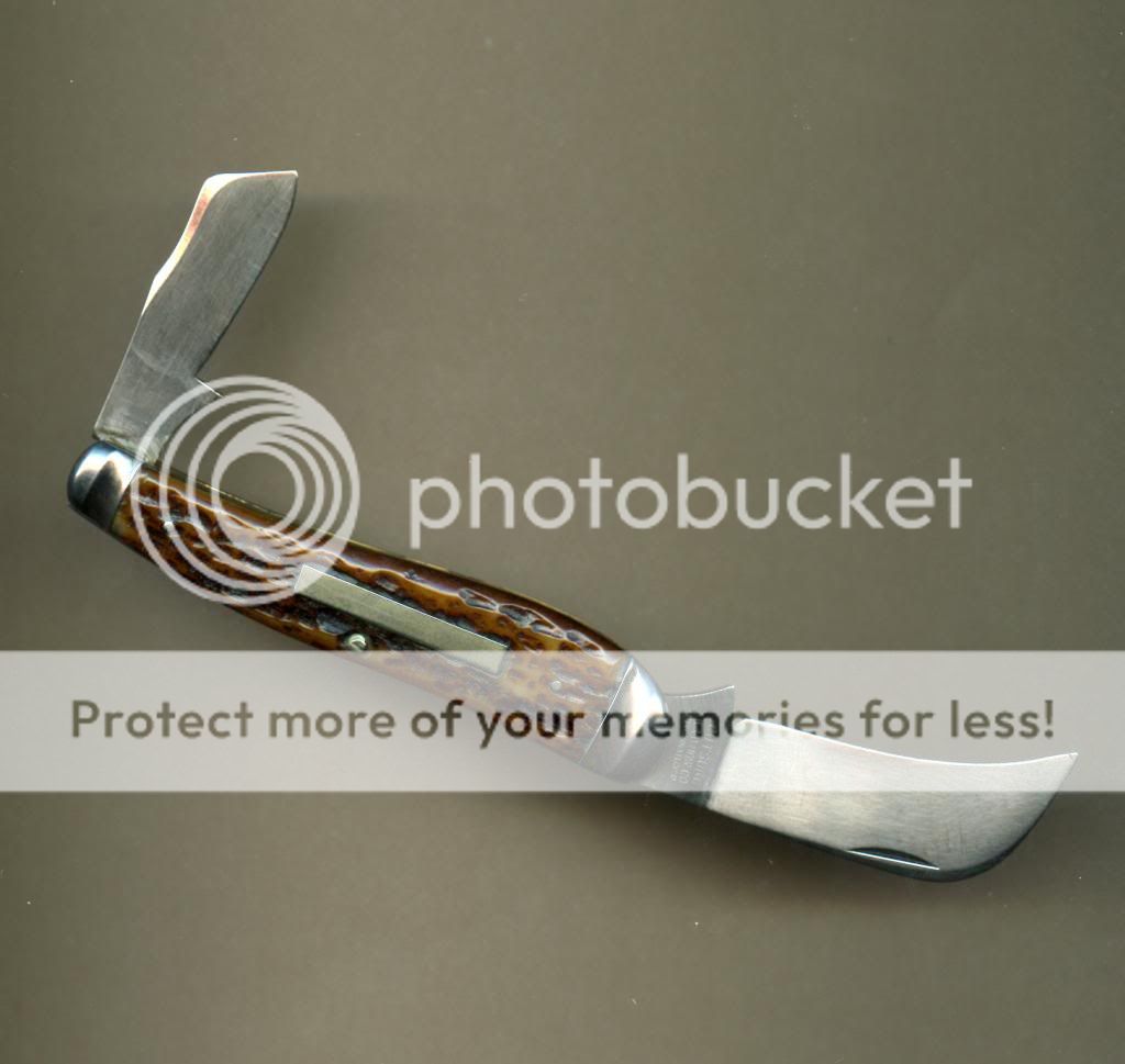

As you might have guessed,this thread is not about farms or farm animals,but it is about the farmers jack, aka rooster comb pattern. It is an obscure,but elegant single spring pattern(almost exclusively),used for budding and grafting. Nestled in a Wharcliffe frame (mostly) with a pruning (hawkbill) on the large end and a spey or budding on the small end.
They are also my quest.
I have not encountered one made much later than a few years after WWII. The latest being Schrade Walden NY USAs all in peachseed bone. Bone being phased out on most Schrades after 1956.
Edit:I Just today have found one with black plastic (?) peachseed ,making it possible for these to be made until '72,when they stopped the Schrade Walden NY USA mark.Ever learning,sorry.
A good internet friend posed this question a short while ago:
"I guess I don't understand why Lyle seems to be the only person that finds these rooster comb farmer's jacks.
What's up with that?"
I hope to bring some out.Let's see your farmers jacks or maybe a "free range rooster". Some of these have been posted elsewhere,some have not.
This one started it all.In return for allowing me his collection(as we seemed the only collectors to focus on this pattern),I gave Mr. Pepper Martin my first.His increased mine 2 fold. Thanks Tony.
And thanks to my many friends I've made along this road,who without(too many to name,you know who you are),these would not be possible.

I suppose I should explain a couple things now.
The common name for farmers jacks( as per Levine) around here are rooster combs (not per Levine :)) . I prefer to call this next one a rooster comb and the standard a farmers jack for these reasons.
First it kinda differentiates and I like to think these are where the term originates (?) .
This ivory Saynor,Cook & Ridal budding and grafting knife has what is called a spud in ivory (natural materials were used as to eliminate contamination during the grafting procedure or so I'm told) opposite the blade. These spuds were used to spread the bark incision in the root branch's bark,while inserting the graft.One end to cut,one end to open.
_____________
Being dull,as not to harm the inner bark,while inserting the graft.
A modification to the back or spine of a farmers jack's spey blade (remember large end hawkbill,small end spey) in about the '30s resulted in a semi-spud. Also included in the modification was a jimped (notches down a blade created to provide grip on a knife ) thumb rest on the tang and a flat sided blade ( to be discussed later).
The result was a blade whose back or spine resembled a roosters comb.
