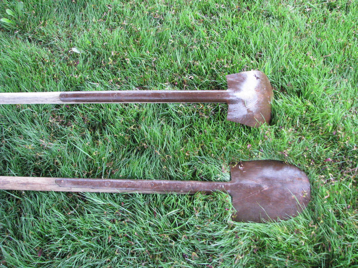

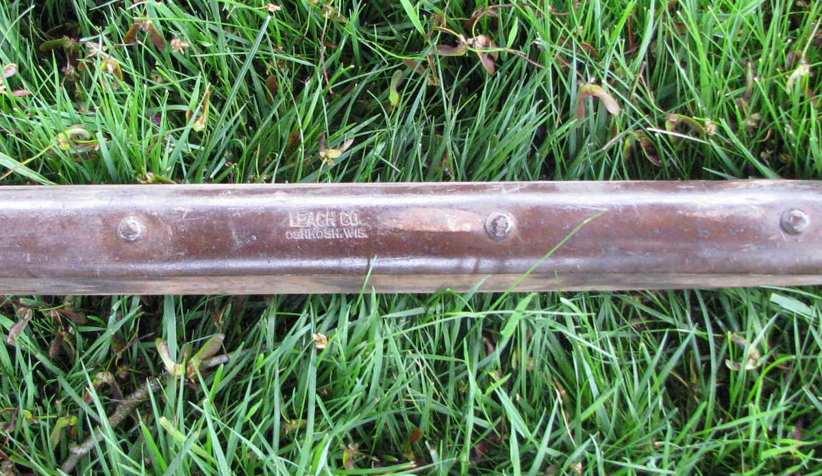

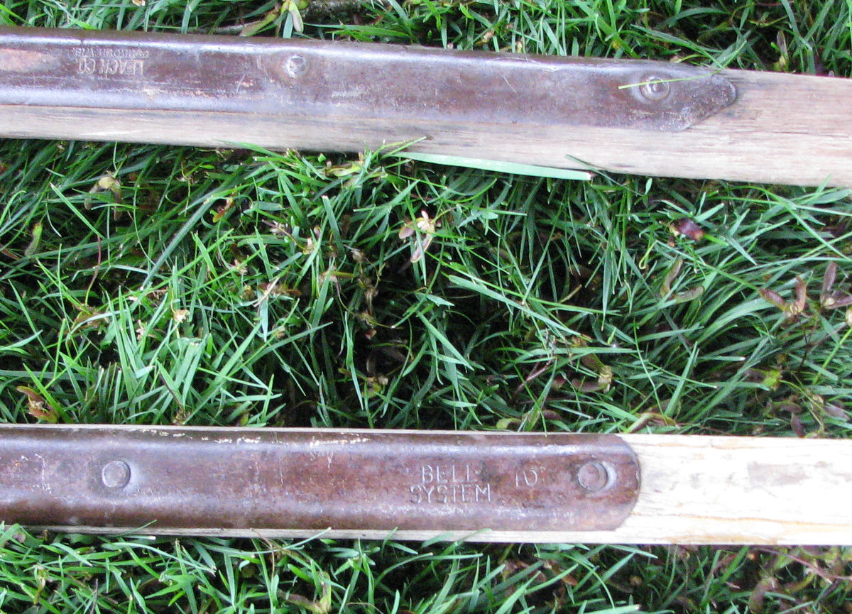

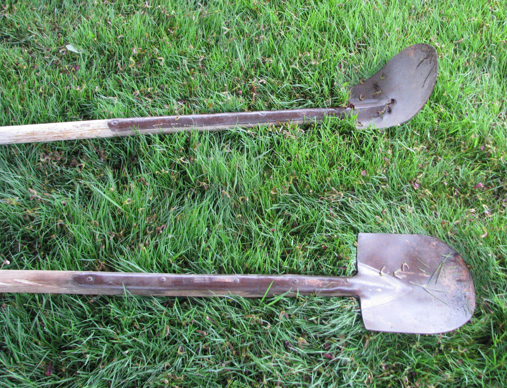

Jet-Lite no.2, is the only thing on it. Thanks!Is the one on the left a Union Fork & Hoe? I have a lovely hay fork by them that has that same split "tongue" running under the ferrule. Those are some mighty nice looking shovels!
OshKosh calls them a spoon shovel and still makes them in lengths up to 16'.
http://www.oshkoshtools.com/products/spoons/spoons.htm
Generically they're called deep hole shovels so I use that term.

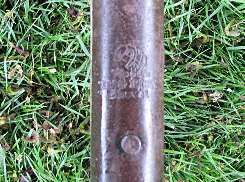

I think auto correct got you guys, the scoop I have says Woods Big FisT Shovel.
That's what I would have called it.Tile ditch cleaner outer thing-a-ma-jig ?
I've seen post hole shovels, though I don't own one. On that lava, you may have to buy your postholes instead of trying to dig them.I had a old post hole shovel that went in straight like a regular shovel then it had a lever on the top of the handle you pulled to change the angle 90 degrees to clean out the bottom of the hole. Most interesting shovel I ever owned. Sure wish I had not sold it in the downsizeing move. I live on a big lava rock now and a jack hammer is the hole digger, then you fill with dirt, then you plant.
The tool for cleaning out the "crumbs" of dirt was evidently called a "crumber", but this also looks similar to the tool called a "bottoming scoop" or "groove cutter", shown here:
