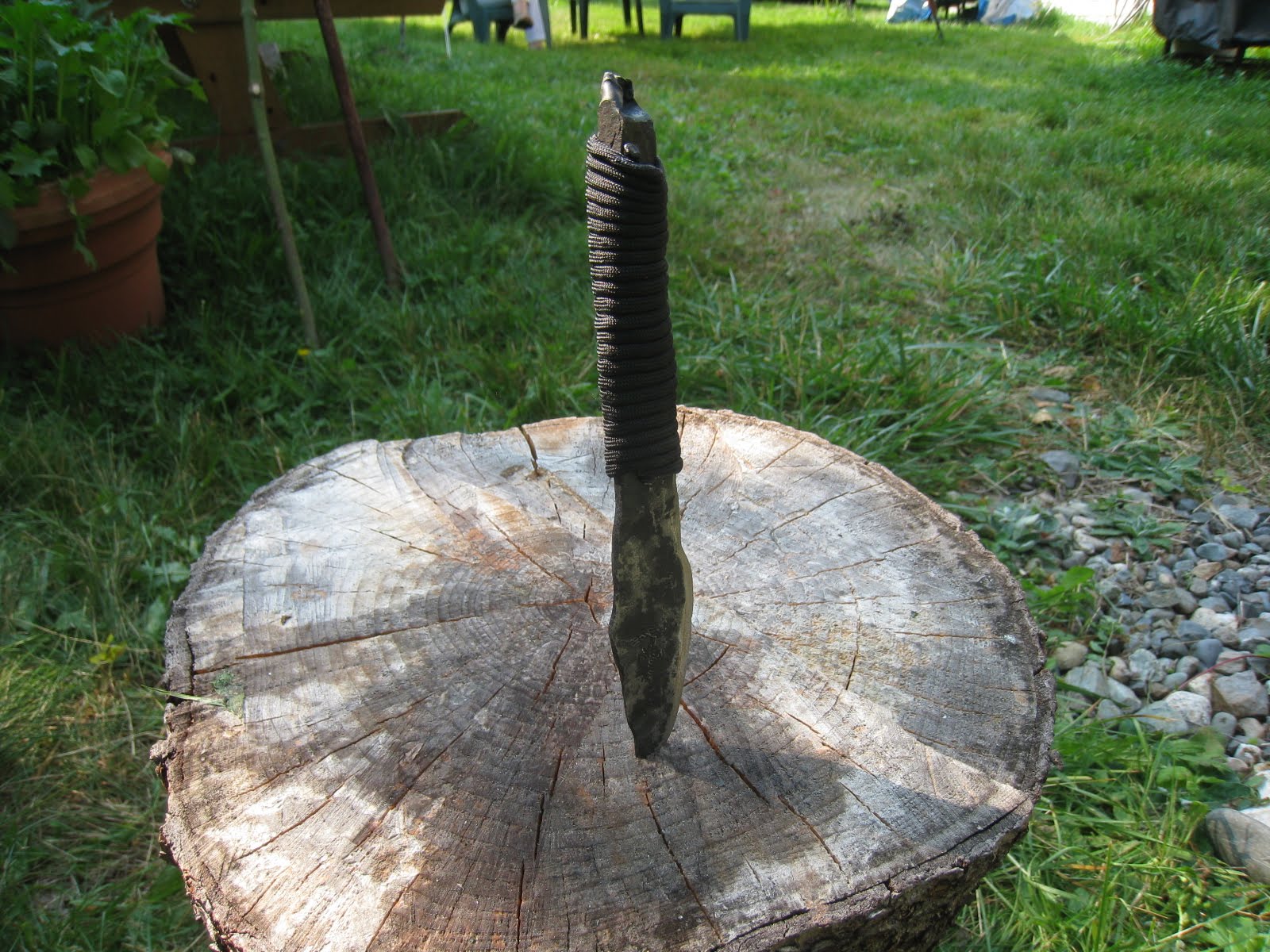

Thanks everybody. That was done as an experiment and as a way to spend an afternoon at our camp. We have no power, no running water, and propane for lights and a fridge there. After a week you get a little squirrelly, so I like to have diversions. On this trip I brought along a 3lb hammer, a gallon container of coal, safety glasses, welding gloves, a few files, vice grips, and a 10" section of rail. The donor metal was a long (8") spike we had found on the clam flats years ago. The shore there was the sight of an old lumber mill and wharf 100 years ago so all kinds of stuff surfaces at times.
So my brother and I built a small fire ring inside our large fire ring, started a fire and then added the coal as needed. We used a broken aluminum tent pole section as a "bellows" powered by our lungs. We had to take turns so nobody passed out :D The rail sat on a stump next to the fire, and from there it was the usual heat, hammer, heat, hammer until we got that blade shape. It was my first time doing this method, so it is as crude as you can see. We formed the blade first and then heated the handle end up and used the end of the rail as a hardy to hammer off at the length we wanted. That part turned out really ugly. Big lesson from that was to do the handle end first and pretty/square it up, then do the blade.
Once the blade was shaped we reheated it and quenched it in a coffee can of motor oil. The edge was filed, paracord wrapped, and voila! Neo-Primitive camp knife for real. Not just a "camp" knife, but made at camp! We plan on doing one or two a year there and leaving them as a collection. Our grandkids, when we have any, might get a kick out of it.
