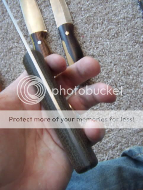

The best I've used are almost one inch near the forward portion of the grip, and usually taper to a bit thinner distally. The BGA bushcrafter was roughly 7/8" or a bit over if I recall (not with me right now to measure). The MM custom puukko that HD has was 15/16" and was not contoured, just a constant width and upside-down egg shape.
Something like 5/8" is way too thin. The woodslore shape itself is actually versatile enough that it can get away with being thinner (though thicker is still better) and I've got a clone that's probably 3/4" or a shade under (thin for me) and it's still 'doable'. I'm still gonna remove the scales on it and put thicker ones on though.

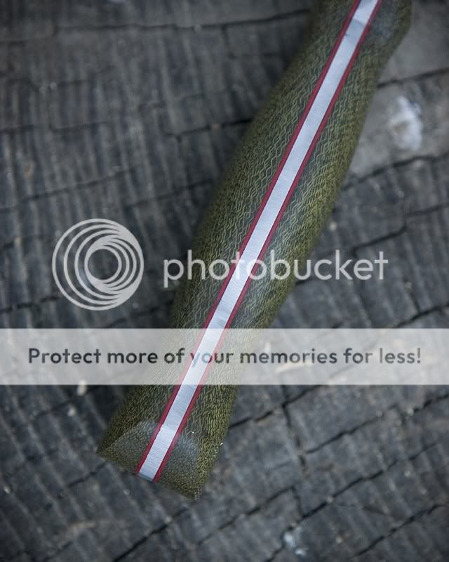

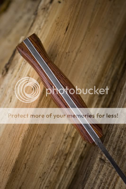

Here's the handle of an EnZo Trapper I made... fits my hand perfectly :)
The hand swells are important to me, even though some people do not like them.
I can give you a dimension if you let me know where.
The problem is, my handles are not circular either. I taper towards the bottom. A circumference measurement doesn't tell all.

Love those handles Brian- except for the red liners. ;) I have a pathological hatred for red liners.

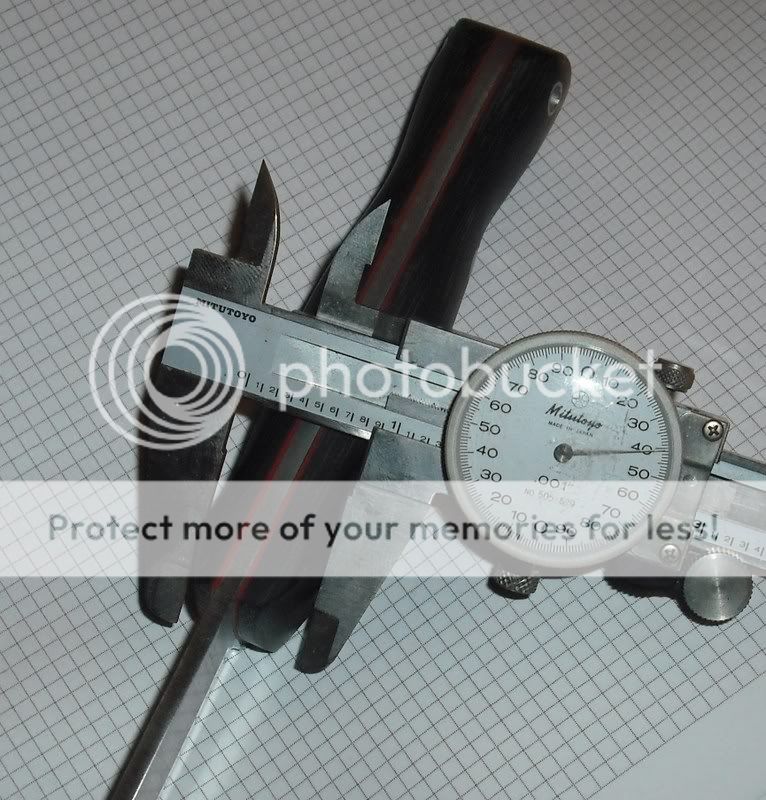

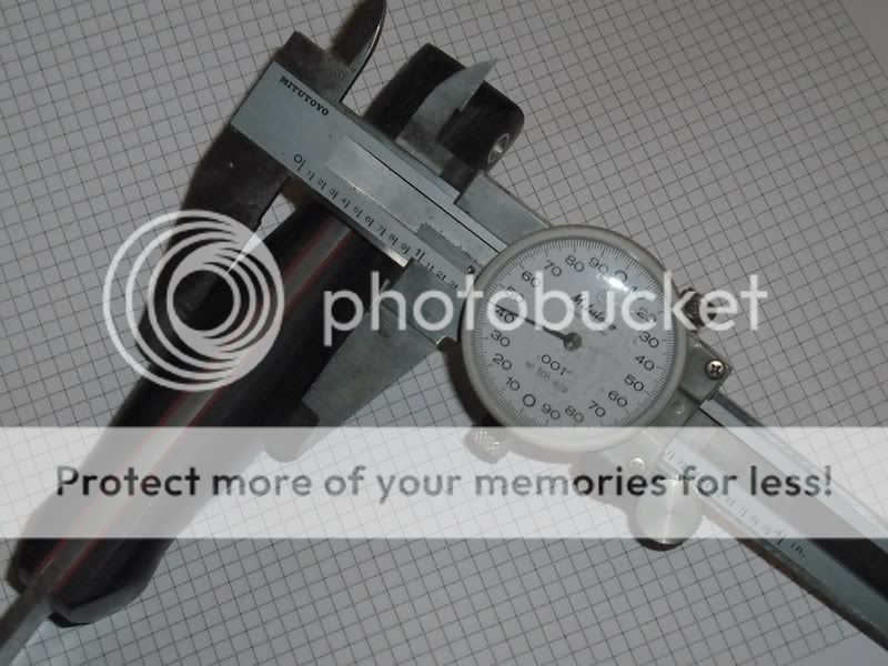

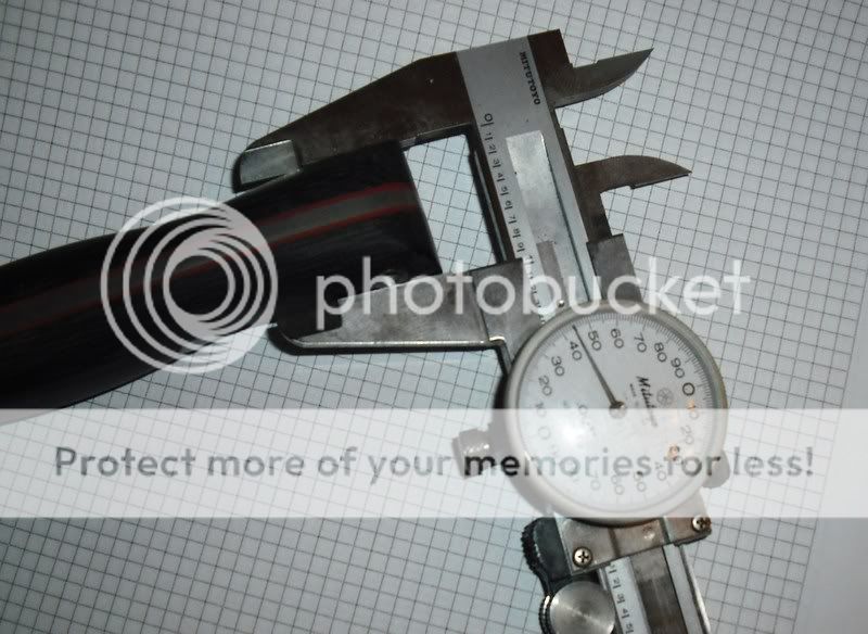

These are the measurments of my Brian Andrews Bushcraft knife:
.944"
.943"
.841"
Very nice fit for my hands.
If you need measurments at any different spots of the handle just let me know.

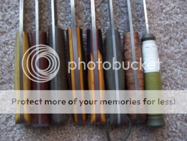

I have most of mine made at around 7/8" wide. Two or three that are 1" wide. Any smaller than 7/8" wide in my XL-hand and I can't feel the handle.
Nice pic of that MM Puukko:thumbup:
I see yours has polished micarta? My Bushcraft puukko came with matte unpolished/dull micarta and I'm rather disappointed:grumpy:
Thanks, that one is HD's. I'm having a similar one made though. If you want it polished up you could do it pretty easily, just use some very fine grit sandpaper and then steel wool. But the 'rough' stuff has the advantage of being extra grippy.
Hollowdweller and Spooky....you guys sure have a nice collection of knives!
B
Hehe, well half are often HD's in my pics. :D
