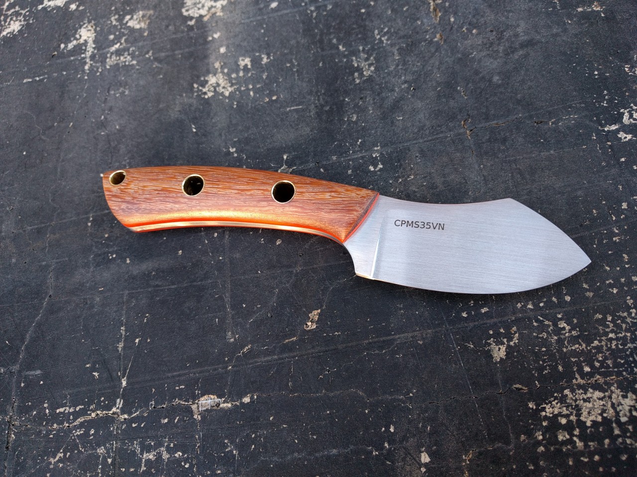

I like several things about this blade. Is this your work?
I remember you saw them ;) my buddy and I working on it ....I have already written a message for you to mail me I have a fair proposal :)
I think you saw these
