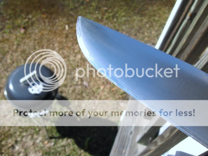

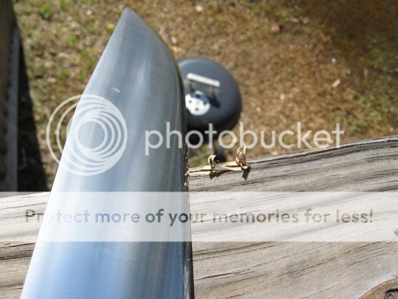

This is what happens when the edge is thinned out too much.
Ankerson
Knife and Computer Geek
Nov 2, 2002
21,094
This is my BWM after chopping wood (Pine), not that bad, but it's the 2nd time it happened. I know I should have changed the edge profile after the 1st time. :yawn:
I thinned out the edge too much, so it rolled and tore out, totally my fault for going too far with it. :o

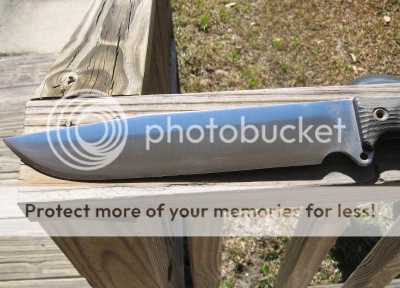

This is after I changed it to a 21 degree edge like it should be, it will be fine now. :thumbup:

Yeah I was stupid to take it down that far (about 12 degrees).... :grumpy: :o

I got it the way I want it now, only took it up to 1,000 grit, nice working edge and it's very sharp and it will hold up now. :)
I can take it all the way up to 7000 grit polish and it will be fine now that I have changed the edge profile. :thumbup:

I've been looking at the first two pictures for a while and still can't seem to find where the edge rolled and tore out. If I'm looking at the correct spot of the edge, the damage there looks to be minimal at best...which is acceptable for a working knife (especially a chopper). I will agree, though, that the second two look really good all polished up :).
It was worse than it looks, the camera angle wasn't that great. :o
But it wasn't as bad as the 1st time it happened, it looked worse than when I hit the concrete with my FFBM. :eek:
The damage was from the tip down about 3 inches.
Looking straight at the edge you could see how bad it really was, I stopped once I saw what it did, it could have been worse. ;)
All I could think of was crap (not the exact word I used), not again, time to reprofile it.

The edge was very thin, I mean VERY thin as in too thin. ;)

I just took it down way too far for a chopper really, it was under 13 degrees. :eek:
