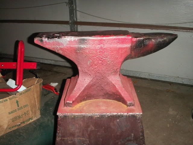

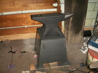

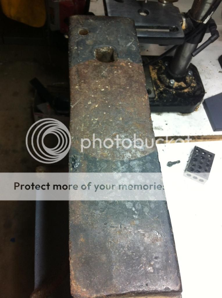

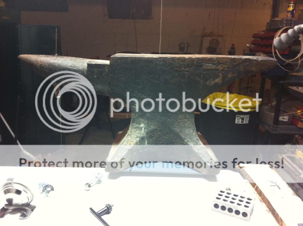

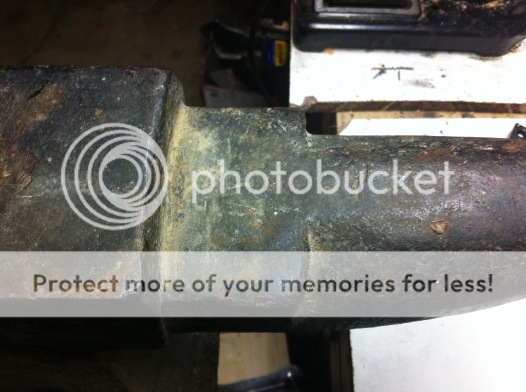

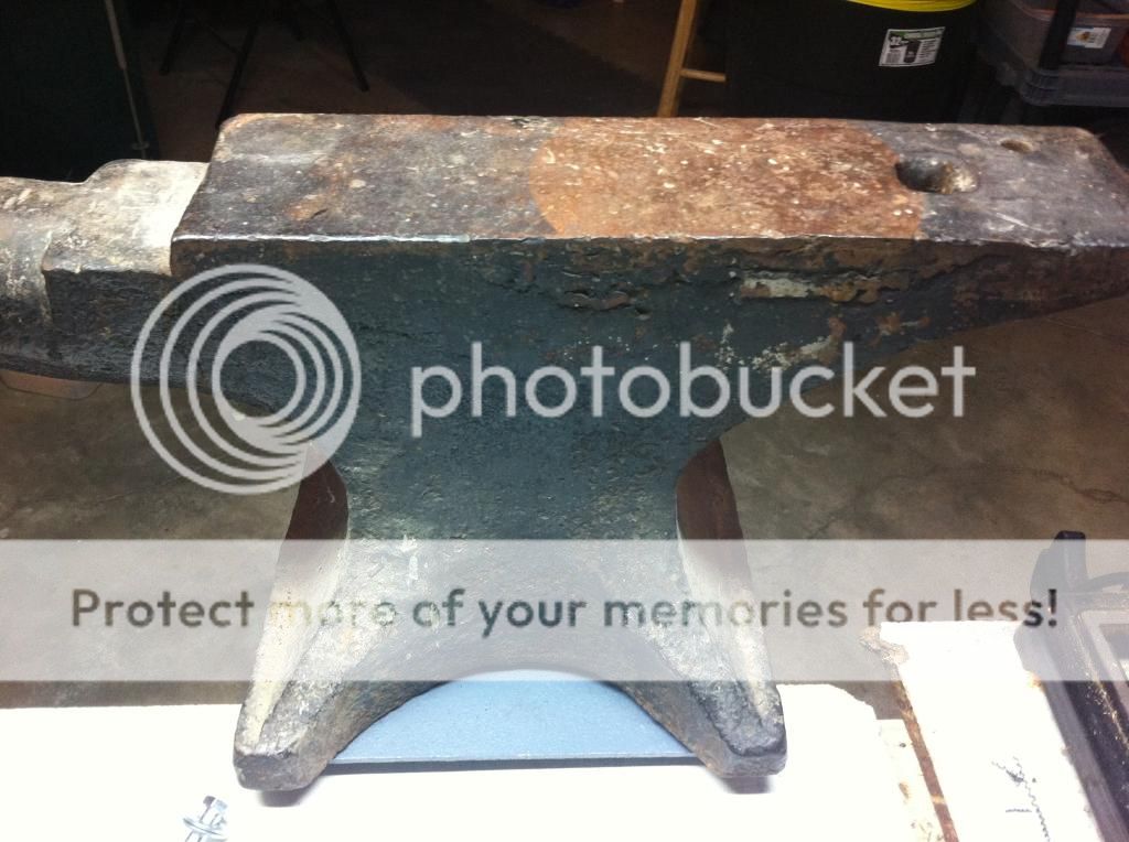

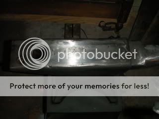

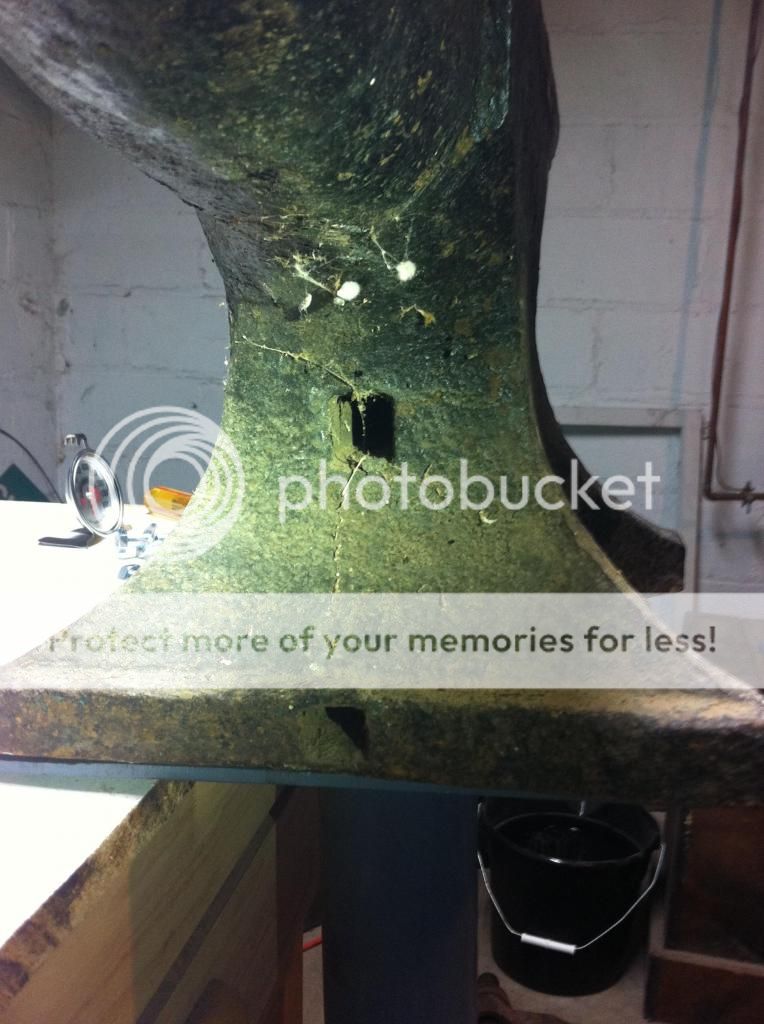

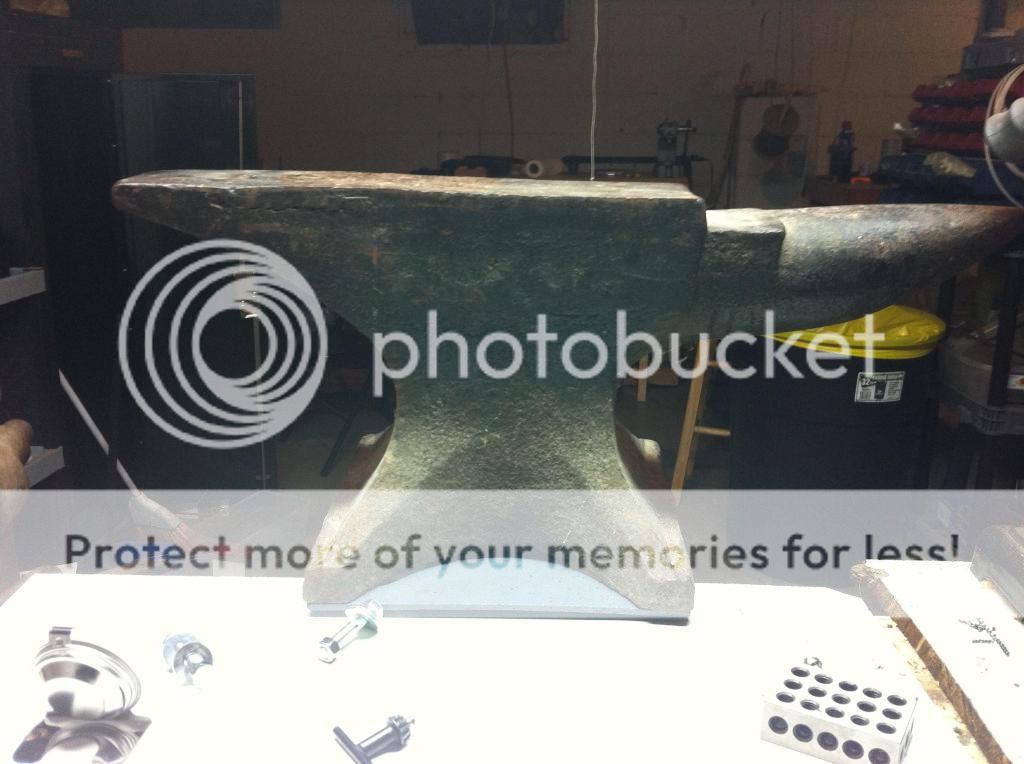

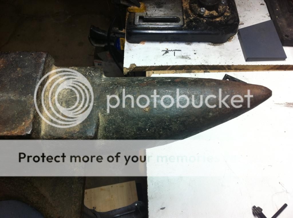

I snagged up an anvil recently and am looking for some info on it and also some advice on how to get it into good working condition. I've done research online and haven't had much luck being able to identify it.
What I know:
There are no markings that I can find.
155lbs
26in long from the tip of the horn to heel
11in tall
Guy I got it from said it was his grandfathers. He was probably 50yrs old so I'd bet its probably at least 90-100yrs old.
There are some minor dents and dings in the face but no where near as bad as some I've seen. I paid less than a dollar a pound so I can't complain too much.
There seems to be good ring/rebound, especially on the center of the face.
Here are pictures:
I've done some research and have a tentative game plan for restoration. I just wanted to get your guys' opinion before I dive in and screwed it up.

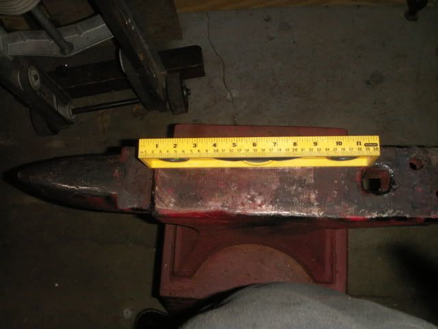

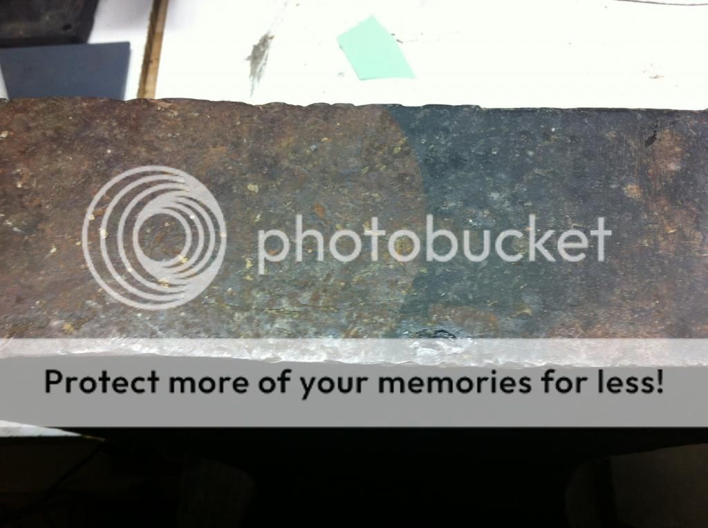

The face:
Use paint or something on the face and drag a metal yardstick/level across it to mark the high spots. Use a flap wheel with and angle grinder to hit the high spots and blend everything together. Repeats the process a few times and work up the grit progression with the flap wheels to get a decent polish on the face. Should I do this with water on the top to keep temps down?
The sides:
I'm throwing around d the idea of using a wire wheel on the angle grinder to remove some of the corroded surface. I'm not sure if I should even mess with that though.
Stand:
4x4s nailed or screwed together on end. Maybe wrap them with flat bar. Possibly use silicone or some tough/dense rubber to quiet it down. I have some horsestall mat I thought about using but its nearly 3/8in thick and that may work against me.
Anyway, I'd love to hear from you guys and would really appreciate some advice on how to get this thing in the best working condition possible.
