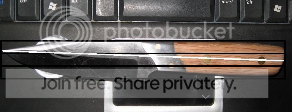

I'm also drawn to the front pin, looks low to me
and I want the front curves of the bolster to be parallel and matched in the back of the bolster
can't tell from here if they are or not.

The use of a straight edge from tip to tang is OK if the blade or handle doesn't have any curve and the tip is centered in the blade. Unfortunately, only a dagger normally has that symmetry.
If there is any curvature, dropped/raised point, etc. the forward pin will be high or low.
Sketch a kerambit and use a straight edge from point to butt....... you will see that the forward pin would not even be on the handle :)
It is the centerline of the handle/blade that you want to follow. The centerline can be ( and usually is) a curve.

Well I solved the mystery of the front dropping pin, this is simply an optical illusion, the top edge of the knife is completely flat, to show that, I squared my camera up to the knife ( that was a bit of a trick) and using the rectangle tool in paint I drew some grid lines, the white line is the line I used to set the pins, so buy looking at this photo the front pin is a tad high, but what you cant tell from the first photos is the handle is tapered in thickness, so what happens, the lower the angle of the camera in relationship to the knife the lower the pin looks
however I agree the front pin should have been place a little higher to compensate for the handle shape.I wont make that mistake again ;0)

What I do in pin placement is make a line similar to the white one on your photo to find the spacing of the pins. Then I use dividers to find the center of the handle at that point. This will keep the pins along the centerline. Even then, I will draw in the pins before drilling the holes. Sometimes it needs to be a bit high or low to look right.
