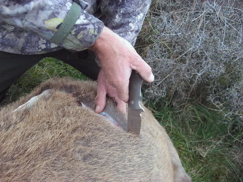

A knife I made as a gift for someone to use on a NZ Stag hunt , he left it with his lead guide for further testing.
the knife that was tested.
http://i262.photobucket.com/albums/ii89/VegasHenchman/Misc/Img_8384.jpg
That is the kind of testing I wish I had the time to put in , but I don't so I have others who do it for me.
