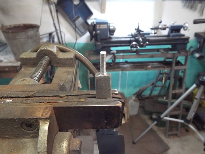

One reason people braze threaded tang extensions on, is to be able to use a bigger thread than the guard will slip over. It works if you permanently fit the guard, then braze your tang end on. The way Stacy describes, of grinding the sides flat to fit the guard over, will often work depending on the knife. Other times, brazing the tang end on allows more flexibility in the design process. I have done it both ways many times.
Here is the last one I did, threading the forged tang end.

I distal taper my tangs and use 1/4-20 for the thread-even tapering from 5/16" to 1/4" works, and for me it's almost always a sword or bowie. The distal helps the handling as well.
Yes, I taper the tang and start threading. The tap will slow down as the tang gets too thick. If needed, I thin down a little more with a file.

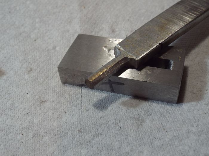

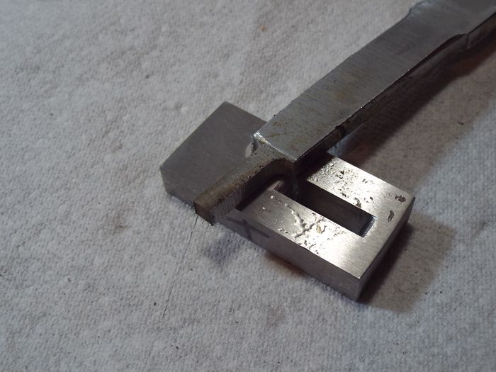

First grind your tang square - very easy on your flat platen - to just slightly larger than the diameter of your thread size. I mostly use 10-32, so I grind to about .200. (Final dimension of .190")
Then, grind the corners off to the same dimension:
Then gently round over the octagon:
Thread:
You ain't gonna break it:
