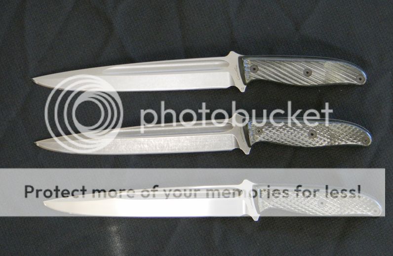

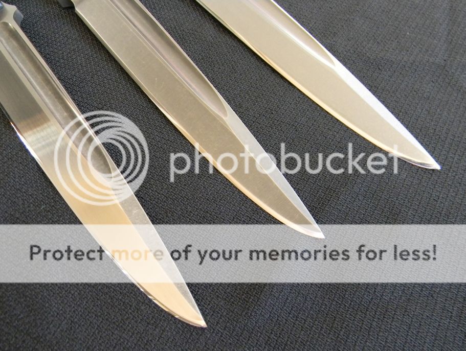

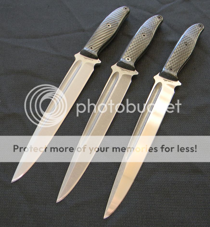

This is a heavy duty combat knife designed as a stabbing weapon and built to tolerate extremely rough use in demanding environments.

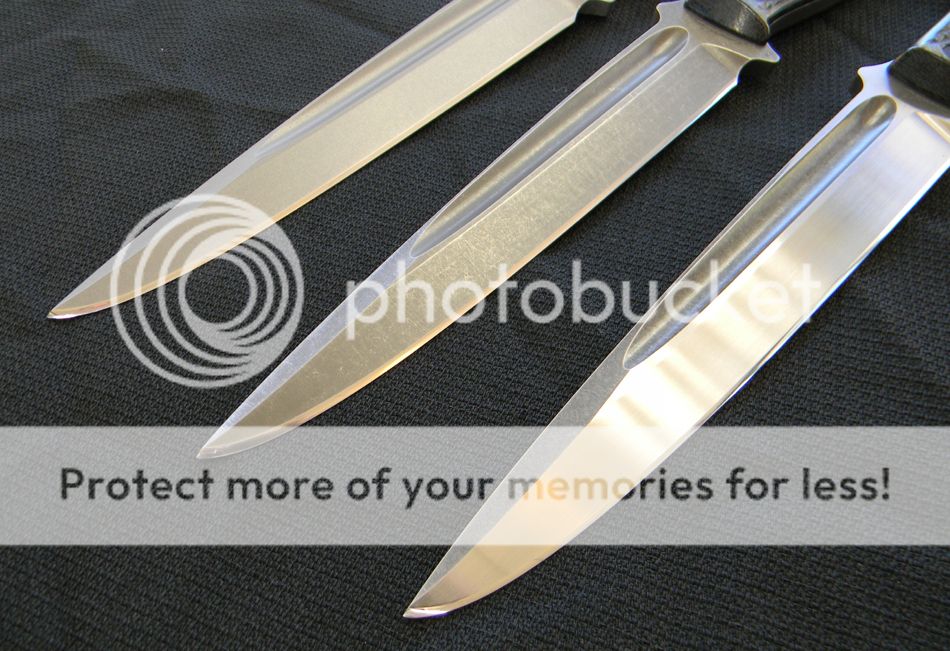

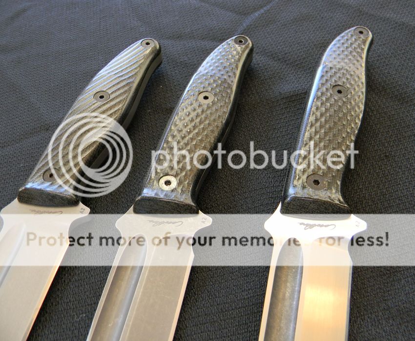

The handle is ergonomically designed for a standard forward, reverse, saber and pinch grips for an average to relatively large hand. The tang is internally skeletonized. The scales are 3D sculpted CNC machined canvas micarta. The blade is made of ¼” Latrobe A2 steel with a heat treat that has been optimized to maximize strength and toughness. The blade has a swedge grind that creates distal taper and deep fullers that, together with the skeletonized tang, create a relatively light weight package (11.7 oz) that is supremely well balanced with thoughtful and deliberate distribution of mass that gives it a surprisingly light and lively feel in the hand without sacrificing tip strength.
The steel, Latrobe A2, is a high quality domestically produced high carbon tool steel (not a stainless steel) with high impact and torsional toughness. It also exhibits good edge stability and edge retention which make it a good choice for rough use. In this application it will tolerate abuse such as aggressive prying, punching holes in sheetmetal, cutting iron wire and even chopping through cinderblock. Being a 5% chromium steel it is not stainless, but has better corrosion resistance than something like 1095.

Extra grippy 3D machined canvas micarta scales

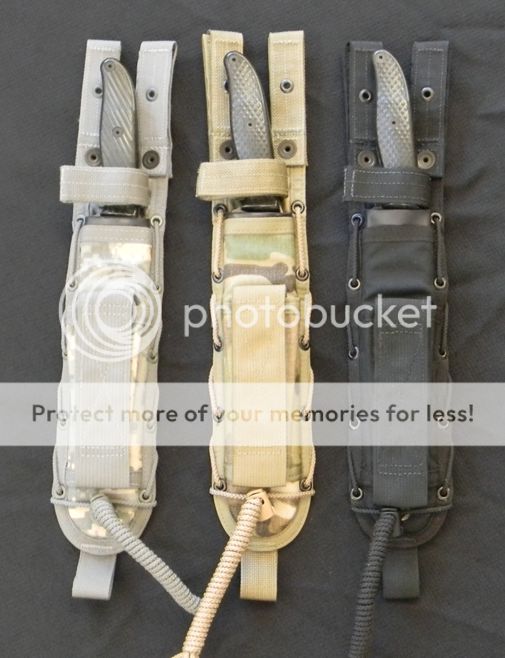

Spec Ops Combat Master sheath can be hung from a belt, mounted to all duty belts, is M.O.L.L.E. compatible and jump certified.

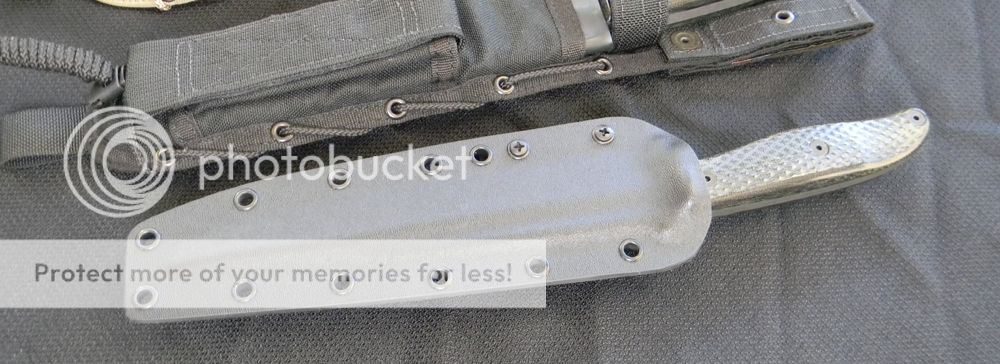

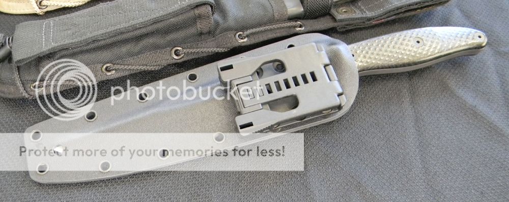

Or for an additional $10 you can substitute for a custom David Brown Kydex sheath instead of the standard Spec Ops. It is not jump certified or specifically M.O.L.L.E. compatible, but it is extremely badass and well designed and it was made just for this pattern. I've included a knife in a picture below to illustrate the kydex sheath. That knife is not for sale, it is just to illustrate David Brown's custom sheath.

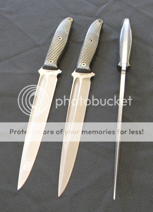

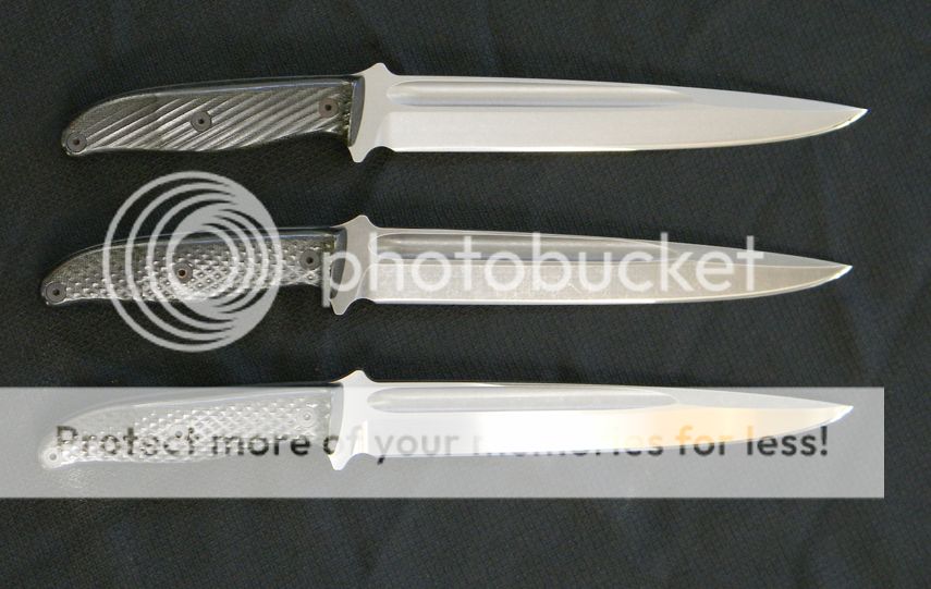

The first fighter in an ACU sheath is “field grade”, “as machined” (with visible tool marks) and mat stonewashed. It has black micarta scales machined in a scalloped pattern. $240 SOLD
The second fighter in a camo sheath is “field grade”, “as machined” (with visible tool marks) and dark stonewashed. It has black micarta scales machined in a diamond quilt pattern. $240 SOLD
The third fighter in a black sheath was dark stonewashed and then ground on the primary bevel and flats, but not the clip. There are fine tool marks visible in the clip, I left them there because the machining is just too well done to grind off, it looks good. It has black micarta scales machined in a diamond quilt pattern. $275 SOLD

These knives are unusual because they are completely machined, not ground. I do this in my shop on industrial CNC machine tools. A WIP thread documenting their construction can be found here: http://www.bladeforums.com/forums/showthread.php/1048443
