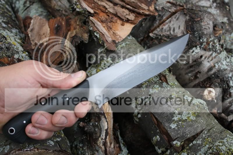

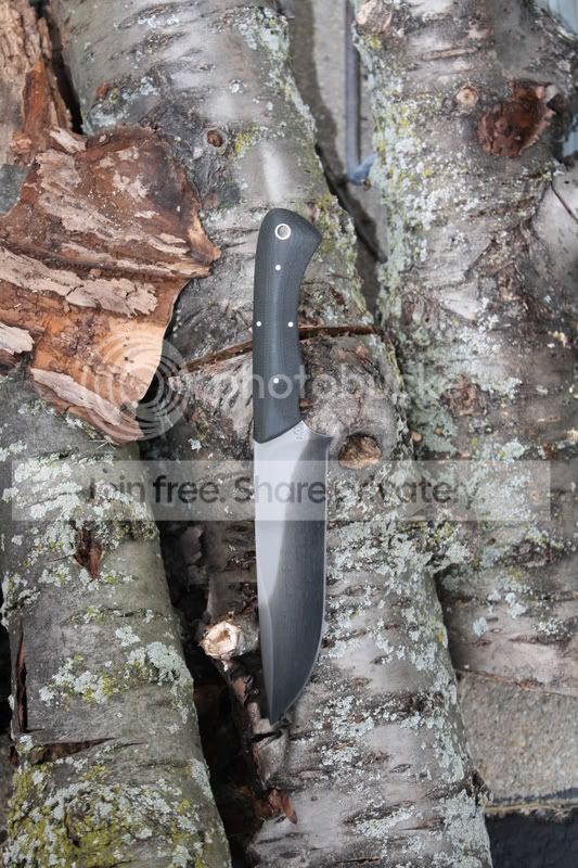

I just wanted to post something new. Let me know what you guys think. Good or Bad, I appreciate all comments:thumbup:
Blade steel on the two smaller ones is D-2
Blade Steel on the larger one is O-1. This one is a scaled up version of the Forum knife I did last year. It has a 6" blade and is a bit wider than the orig.
Nick:)
Nick, dude those are awesome. I like the big forum knife alot. I had a chanceto play with one of your knives a few weeks ago. I was really impressed. Very comfy. You sir, do great work!
All are very nice, but that big one looks like a manifestation of how it feels when you see your first child born. You just stand there, holding it lovingly, telling it "I'm going to love you more than anything in the world... until the next one comes along." hahaha
Nick,
ok just a quick looksy and you know I love your blades ,I will soon be owning 5 of your Great Blades :thumbup:..OK,I like the little blade from D2,looks great and very useful,the larger one is cool as hell but to me it has a tactical look to it (not that it is a bad thing),I do like it but not a big fan of swedges on big blades.not saying I would not buy it down the road ;) LOL !
I would love to get some specs on the little D2 knife & $$...:thumbup:
Bro your killing my stash cash big time !! :D Great work & you are an Excellent Craftsman !!!
Damn I gotta say, that large one is awesome. I haven't gotten a new knife in quite a while, I may have to jump back on your list! Nice work as usual man.
No thinking necessary when it comes to your work Nick. Fantastic stuff! Those look GREAT!
Thanks for all of the positive feedback guys:thumbup:
Tony, you're right my friend, I was going for more of a tactical look.
Thayne, I think you really do NEED one of these:D
All of these are for a very good customer/friend of mine. Maybe he will see this and post a reply too.

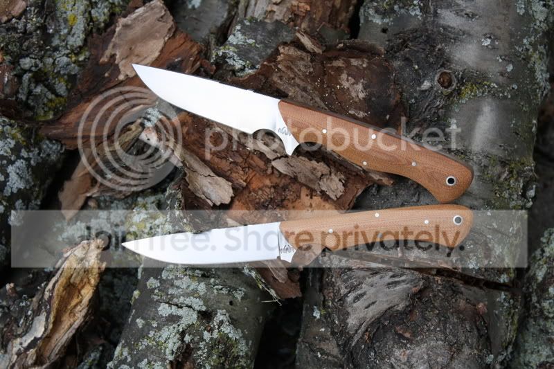

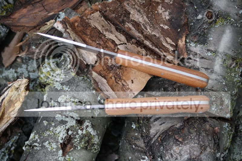

Ok, here is a couple more shots of the smaller two.
Dimensions are as follows.....
The one without the finger choil is...
1/8" D-2 Ht'd to 60 RC
8 7/8" OAL
3 7/8" edge length
blade width of just under 1"
Natural Canvas Micarta Scales with Stainless Hardware
The one with the choil is....
5/32" D-2 Ht'd to 60RC
9 3/8" OAL
3 5/8" cutting edge
blade width is 1 1/8"
Natural Canvas with Stainless hardware.
Let me know if I missed anything
Thanks
Nick:)
That bottom little slim one looks real handy too. Looks like the perfect small hunting knife or slim hiking blade, very cool.
