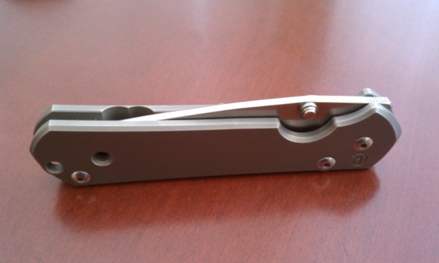

I need to do a couple of things to make this the perfect folder (for me). One is to get rid of the blue accents, and it's in CRK's hands as we speak to swap out the blue parts for silver.
Second is to flatten out the pointy thumbstud to improve comfort as some of you have done yourselves. However, I'm more than just a little uncomfortable with guessing how I need to go about this. This is a top shelf knife, and I don't want to cheapen it with an amature-ish modding job..
Can anyone provide good step-by-step instructions on how to do this?

What do you want to achieve? For example, simply grind it down and leave a flat surface or smooth out the point and keep it contoured?
A flat surface - exactly like this (borrowed from bunghole's post):

Step 1 - Grind it off flat until you have gone as far as you want.
Step 2 - Polish flat surface.

Thanks, but I already got that much from Bunghole. I need at least some level of detail to get it done right. What do I use to "grind it off"? (file (if so what kind), dremmel, what disk, how to get it and keep it level while grinding, etc..)
Polishing is easy - no additional detail needed there.

If you really want to ruin the thumb stud and de-value your knife. Here is how you do it, use a dremel with a grinding stone. Tape all around the stud in case you slip. Protect all of that side of the knife. Grind a little at a time, until you remove the material you want to. Then polish the stud. Good Luck
Well for me, it would be fixing the thumb stud, but I grant you it will de-value the knife. Fortunately for me I am not a collector, just a user. This is the perfect user knife - I can't see ever putting it up for sale anyway..
Thanks much for the additional detail. I've got a dremmel, and hopefully very steady hands...I guess I'll just try taking off a tiny bit at a time and tape everything up like you mentioned.

I personaly am not a huge fan of the regular thumb stud on the Sebenza although it works fine I just don't like the domed look and also don't like the stud on one side. (CRK offer double studs but they are not standard) I just changed mine to a BM mini grip stud and that has worked very nicely for me. The studs on the Sebenza are just pressed in so they are easy to remove. There is really no need to try and polish, file or grind it while still on the blade, if that's what you want to do. :):thumbup:

Did you just use a punch to remove the Sebbie thumbstud? How did you get the BM stud to fit?
I wouldn't use a dremel but that's just me. I would use a flat file, sandpaper on a hard flat block, the platen of a belt sander. A tiny grinding wheel on a dremel would be, imo, hard to make a perfectly flat surface.
Thanks richstag - I'm actually thinking the same thing. I think I'll go out and find a very fine file and just take my time with it by hand.
