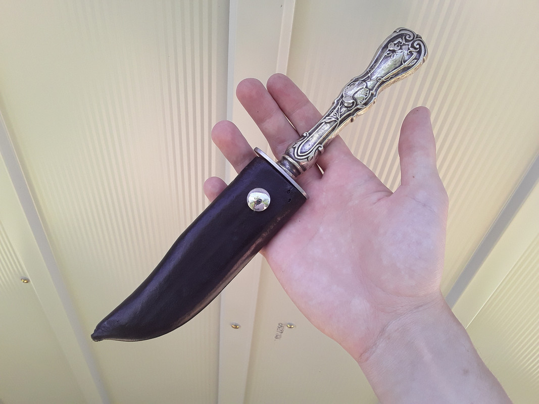

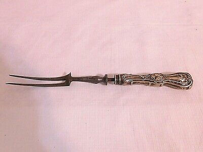

I've got a sort of gold rush bowie or " California knife " style project planned ( I've got the knife and silver handled carving fork on the way ) and was thinking of going with a center seam style sheath for it.
I've never made one before and I'm not sure how one would go about forming a center seam sheath that follows the contours of a clip point blade.
Would I need a wood insert ?
I would love any tips or tricks to making such a sheath if anyone here has made one before.

have a look at scandi sheats, they are made with a center seam.
I make them without a wooden insert but it could be done.
Make a measuring strip out of the actual leather you'll make the sheath out of and measure at several points, but do not let the sheat become narrower towards the top(the wider bottom has to go trough)
I haven't made that style sheath, but it seems to me, you could just glue a welt in where you wanted the seam. Then run a row of stitching down the center of it. Or depending how the cutting edge was oriented, you might not need the welt to protect the stitching, and just stitch in the seam where you want it.

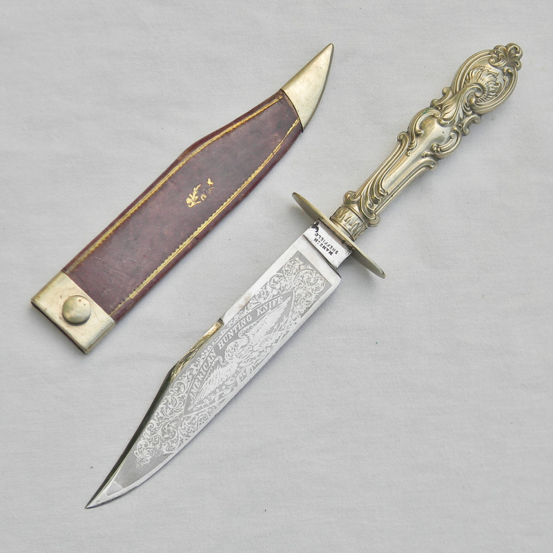

This is what I've got in mind.

Hmm, yeah, I haven't seen something like that listed for sale. Maybe someone else has a source. I'm thinking you might have to make your own. It shouldn't be to hard. Get a thin sheet of brass, or metal of your choice. Form it around the sheath and solder in the back. You can probably find thin brass sheet at your local hardware store. If not Jantz knife supply and Texas knife supple, both sell several different kinds of metal sheets, copper ,brass, nickle silver. I would make the sheath, and then whittle and sand a wooden mold, the same size and shape, to do the metal forming and soldering on.

I think I'm going to have to pass on the fittings.
The nickel silver is going to cost a bit too much for me to likely waste not knowing what I'm doing, and copper from the local hardware won't match this silver handle I'll be using.
Maybe I can use aluminum and give it some kind of wash ?
$15 for a .032" X 6" X 12" seemed affordable to me. But what do I know?
O.B.
Thats what I thought, but with shipping it would cost me almost $30.
Chances are I'd go through the whole sheet trying to get it right and the results would not be that great.
From what I've read the tip which I found out is called a Chape is generally not a very easy thing to make, I will practice at this skill with material I have on hand so I can potentially make one in the future but at this point I'm not ready to spend material on this.

Practicing with what you have makes a lot of sense. I can see how the angles involved complicate things. I hope it proves easier than you expect. Good luck.

The tip and throat of this type of sheath are made using metal forms fabricated to duplicate the sheath shape. Typically, they are done in two halves then silver soldered together (assuming nickel silver). When polished, the joint will almost be invisible. It does take some time and skill but can be pulled off with some patience and care. The interior piece is generally made from layers of heavy leather designed to hold the blade securely and then wrapped with thin leather and stitched on the back. It can also be wood formed to fit and the covered but that is less common.
Thank you for the Info.
I've decided to skip the fittings, but now have to decide whether I want to go with leather inside or thin plywood which I have loads of.

Split some larger caliber rifle brass down and practice making shapes with that. Once you got the dance down, you can pony up for the nickel silver and it wont seem so risky then.
