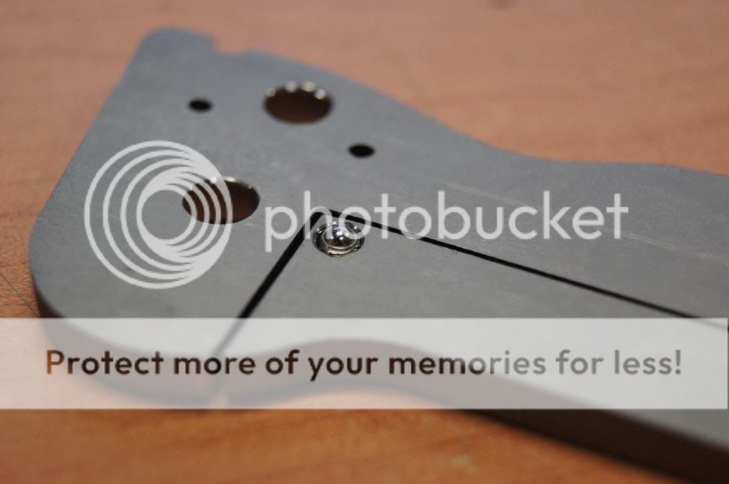

The blanks have been suface ground and the fixture plate has been reamed to spec and all mounting holes tapped to 6-32. I chucked it in the mill after zeroing out the vice. Pretty flat!
I'm a perfectionist so I went ahead and ran a skim pass to just make sure the fixture dead nuts flat.
Next the pivots were reamed to .2495 undersized. After heat treat I'll go back and lap them with diamond paste to each individual pivot barrel.
I turned down the counter bore's .25" pilot to .2495 to match the pivots and sank a .070" deep pocket for the bearings.
Everything fits perfectly!
