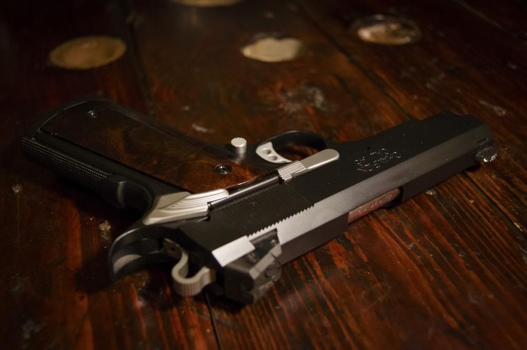

Working on them all at once. That might change a wee bit when I do the final finishes. I nailed down the graphite finish cerakote today with a 1911 I had laying around. Perfect balance of matte/satin. I'll post up pics ASAP.
OK so some of you guys emailed asking about the finishes. I've been working on perfecting the Cerakote finish so I wanted to show you guys what to expect. This an old 1911 project I had unfinished laying at the shop so I figured it would be perfect to give you an idea of the satin/matte graphite color I'm aiming for. It's a 30:2 ratio that is sprayed on after a media blast of 80 grit AO and then baked on at 250 degrees for 2hrs. Final surface is smooth with a micro pebble texture up close. Very grippy and completely solvent/corrosion resistant. Thanks for all your patience these TiTANs are looking real nice! More pics and updates to follow.
That Cerakote finish looks great! I might have to rethink my finish choices now. Thanks for sharing Will
