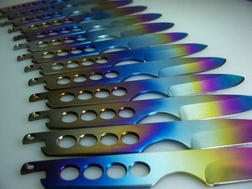

These are sold, I may have extras in a few days though!
Wow! very cool looking. Congratulations to the lucky 12 "Disciples of Ti"!

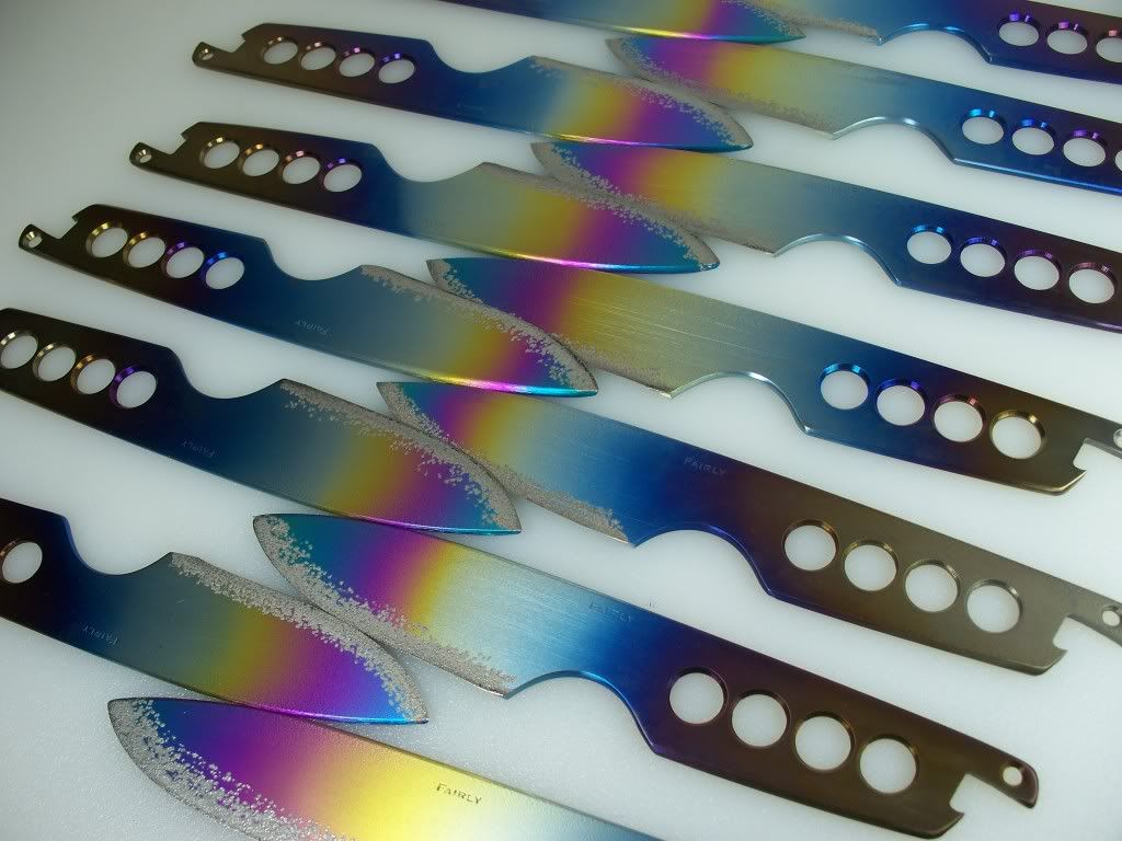

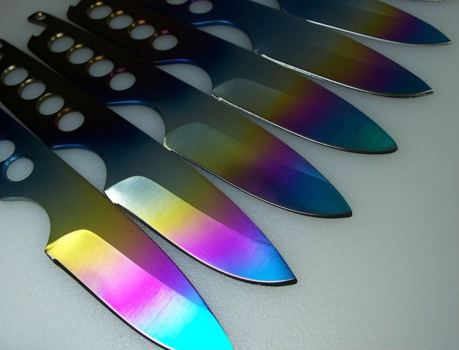

I had a question about the carbidized edge ... what it was, here is my answer.
That is Tungsten Carbide you are seeing, it is what enables the Ti to have a lasting edge. I weld it into the edge and some remains on the surface as well.
Carbidized Titanium cuts very well, it can be made hair popping sharp. The edge can saw as well, the edge reminds me of a very fine saw.
Carbidized Ti excels in cutting meat, vegetables, rope, cardboard and other lighter objects. It is not great for carving tough hardwood or twisting cuts. The cool thing to me is that with abrasive materials such as cardboard it is actually self sharpening!
Those look great!
Finally will have 'teeth' of my own to take into the sea... just in case of meeting fish... :D

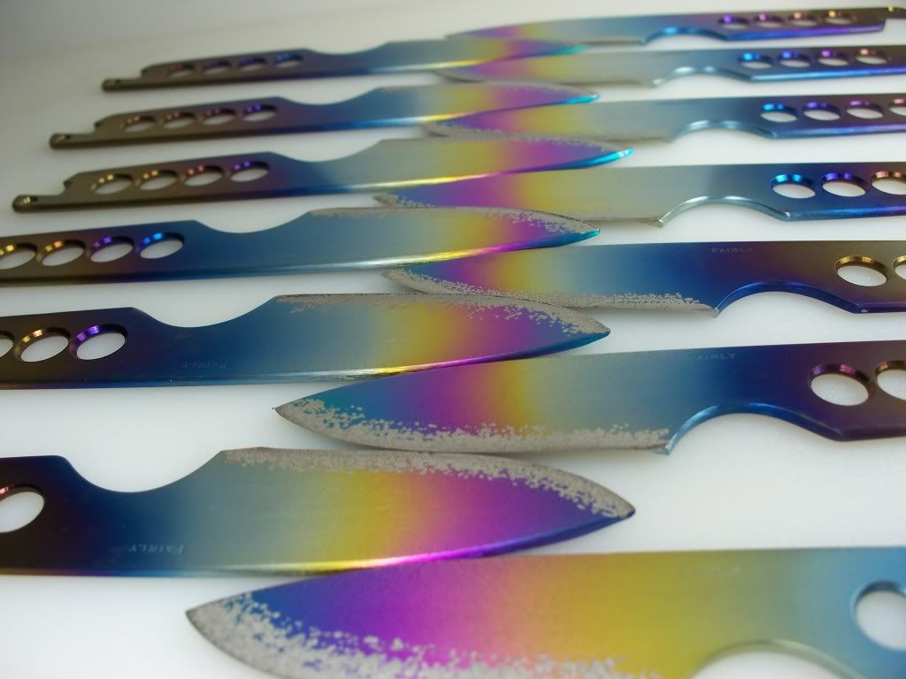

That's one sharp rainbow. You're annodizing is very bright, not sure if your camera is awesome or your annodizing skills are awesome...probably both : ) I'm still stoked for the folders. Saving all my pennies lol.
Thanks!
I am getting better at photography but my camera is old and inexpensive. All my pics are with the same camera, if you look at my older ones they are pretty bad. I take lots of photos!

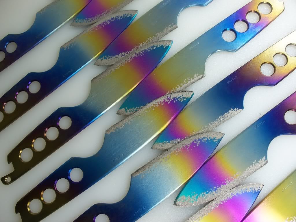

The anodize job is super bright, maybe even better in person. I have been on somewhat of a mission to get the brightest and deepest ano possible, luckily it is working out well. At the moment I am working on a top secret electrolyte mix to get the brightest greens, it is the toughest color to get.
Thanks!

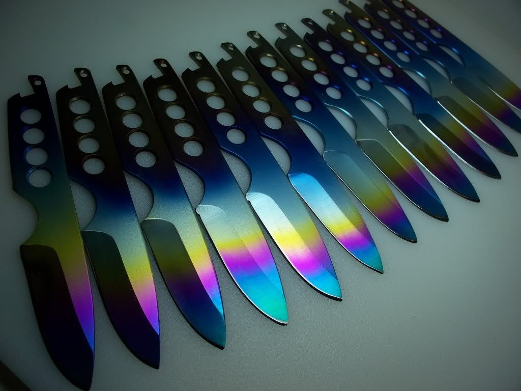

This thing is SWEEEEEEEEET!!!!Thanks Daniel:thumbup::D
Sorry about the low quality pics
