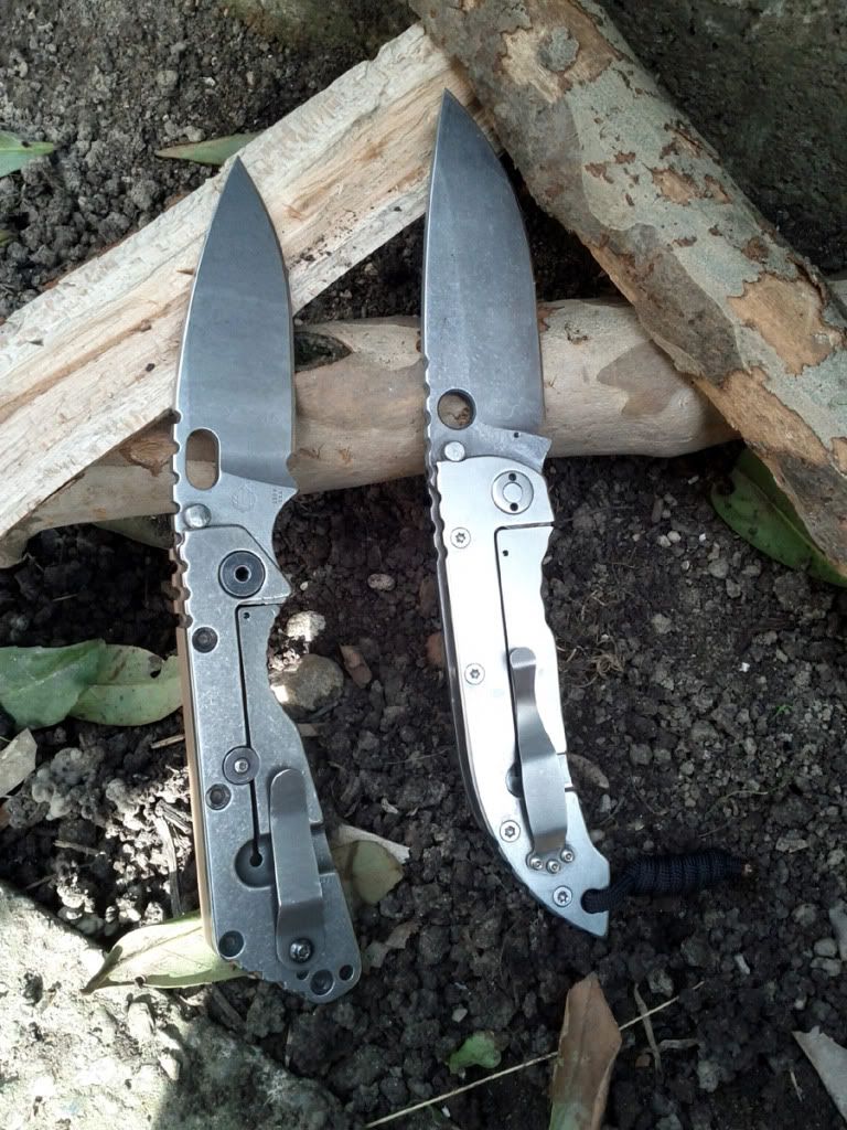

here's a comparison pic with smf

Comparing it to a strider is doing your work a great disservice!
