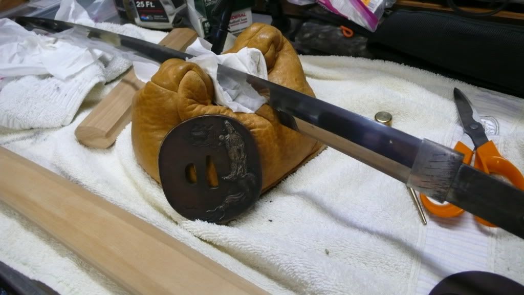

Swords used in actual battles were nicked and damaged and would get polished overe and over again hence. The term a tired sword
I have Katana in my collection that are hindreds of years old and they exhibit this malady
Yes it is always advantages to block on a flat or even spine but in reality swords meet edge to edge in the heat of battle and blades were damaged
Here is one blade that I had sira saya made for it that is not that tired but has fine edge do damage if you look closely
Disregard the Tsuba it was just a prop and of course dots not go with the sword
