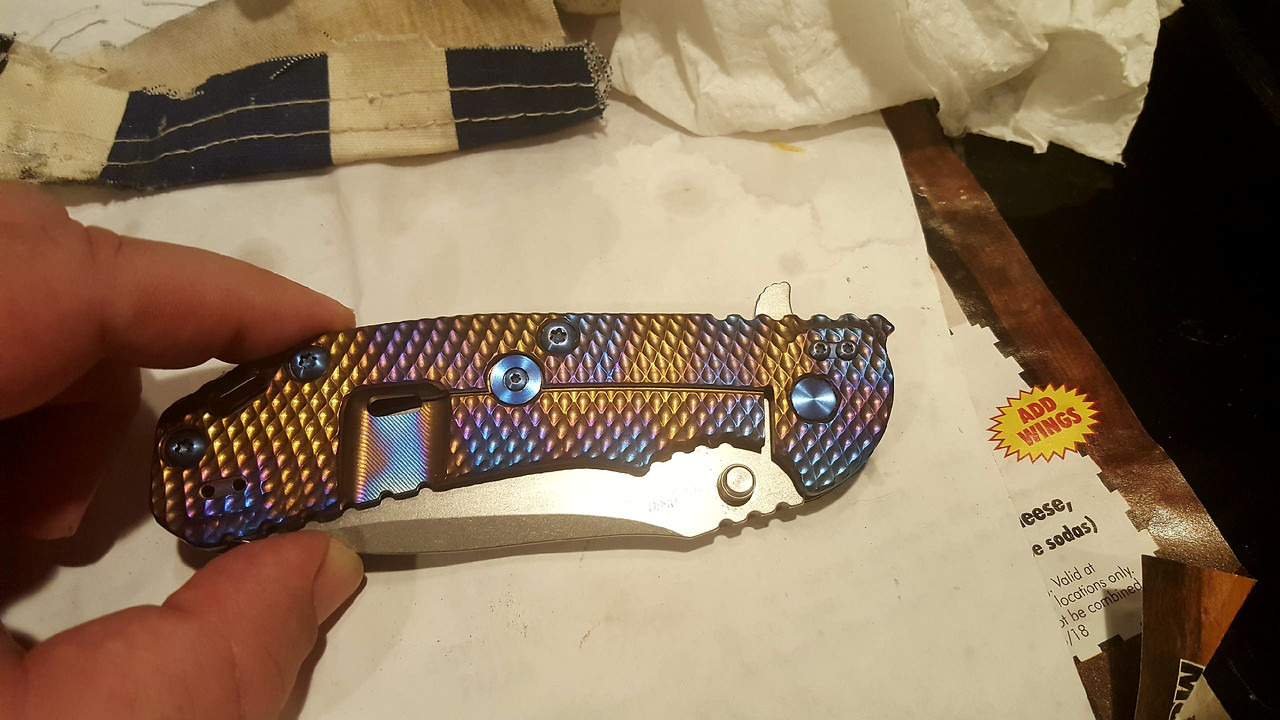

Where can you find a tank that large and a power pack to go with it?
Don't need to electro anodize Ti. Ti can be heat anodized which is what I suspect 910 Stryker M2HSSR was suggesting.
Yup I heat anodized mine. I've also anodized things using electricity, but I like the color transitions from heat. You don't need a tank to use electricity. You can use a sponge or even a paintbrush to draw. Each method has its uses. Here is my zt 0560 that I heat anodized. The screws and pivot were anodized with electricity.
