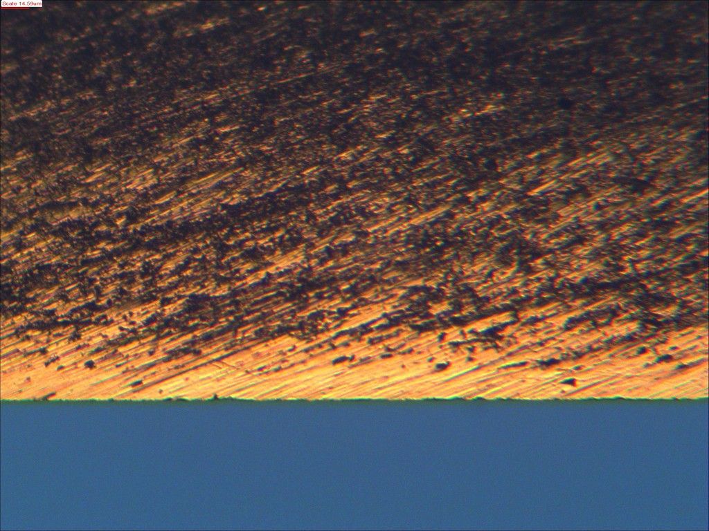

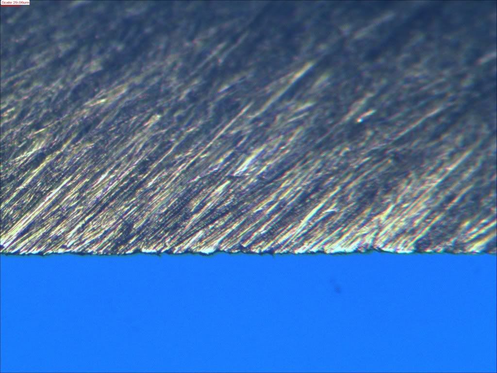

Awesome photo, Obsessed. Do you have any sense of how sharp the apex was after the wire edge was lifted off?
Thanks. The wire edge was enough of an eye-opener to me, that I felt it deserved a pic or two. In one look, it illustrates what a burr or wire edge looks like, how it can eventually break away from the edge AND how tenaciously some burrs can hang on, and how relatively clean and sharp the remaining edge can be, after the burr breaks away.
After the bigger portion of the burr came off, the edge was pretty sharp, but still warranted some stropping to clean the remnants up. I tested the sharpness by slicing phonebook pages, on which some small remaining bits of the burr were snagging a little bit. I was 'experimenting' with a couple things at once; the Spyderco medium stone was part of that, because it was previously little-used and I wanted to get reacquainted with it, even trying the stone with some mineral oil. The other part was an improvised green compound-on-cork strop I was trying out. In the 2nd pic of the closer view, some of the green-tinted cork bits can be seen clinging to the blade, after I'd given it a couple swipes on the strop. My Victorinox paring knife has frequently been the 'crash test dummy' for such experiments, because it nicely rewards the things that work with a screaming-sharp edge, but won't respond to sub-par ideas of mine. Sort of 'inconclusive' results with the cork strop this time around; most of that wire edge I subsequently stripped off by draw-cutting into some wood, and then did the finishing touches on my good ol' reliable leather belt with some green compound. ;)

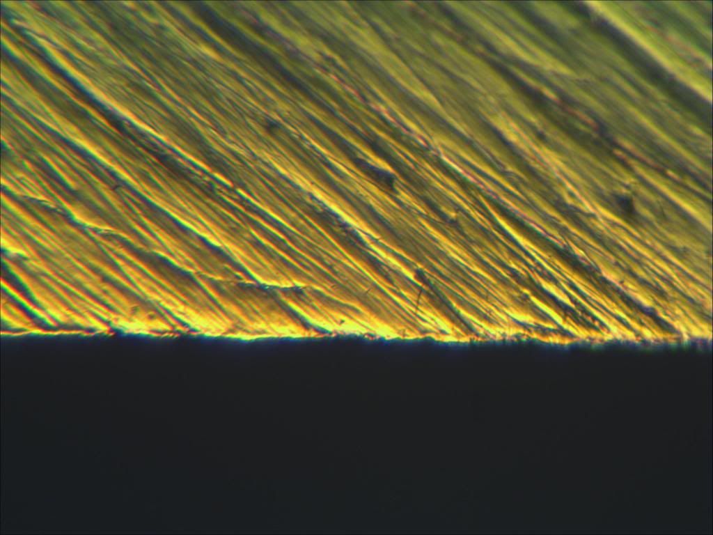

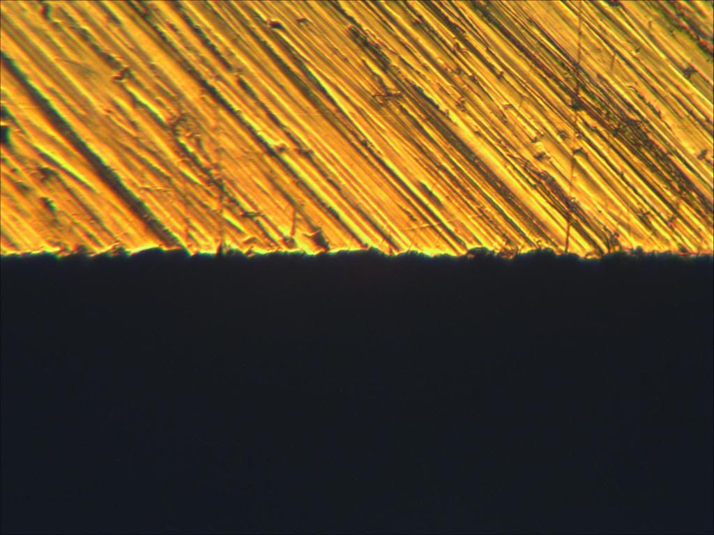

Same steel, same stone, first pic with slurry, second is no slurry. You can see in the slurry image almost no trace of the track marks stopping in mid grind, the average depth is less.
This is a micrograph of an edge done with a muddy 1K and finished with a few passes at slightly higher angle on an 8k polishing stone. You can see the pitted frosty appearance of the 1k. To the naked eye it just looks like a frosted scratch pattern with microbevel.
Silicon Carbide stone with oil/mud:
India stone:
