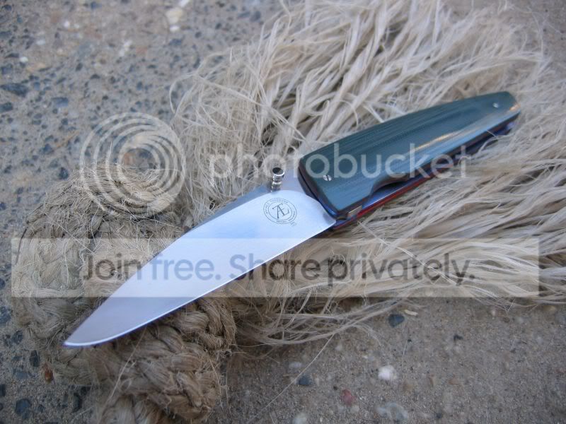

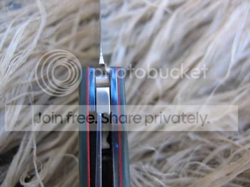

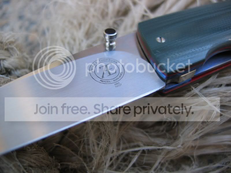

Do you have a shot of the Thorburn knife?
-Cliff
My pleasure.

My pleasure.
Thanks, nice looking knife.
