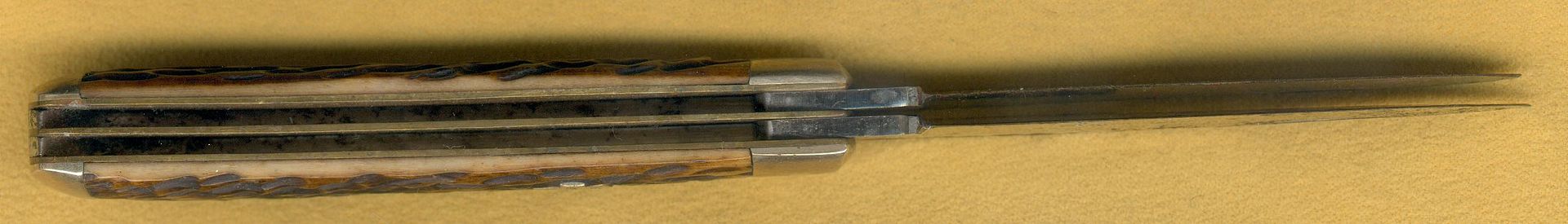

The pics;

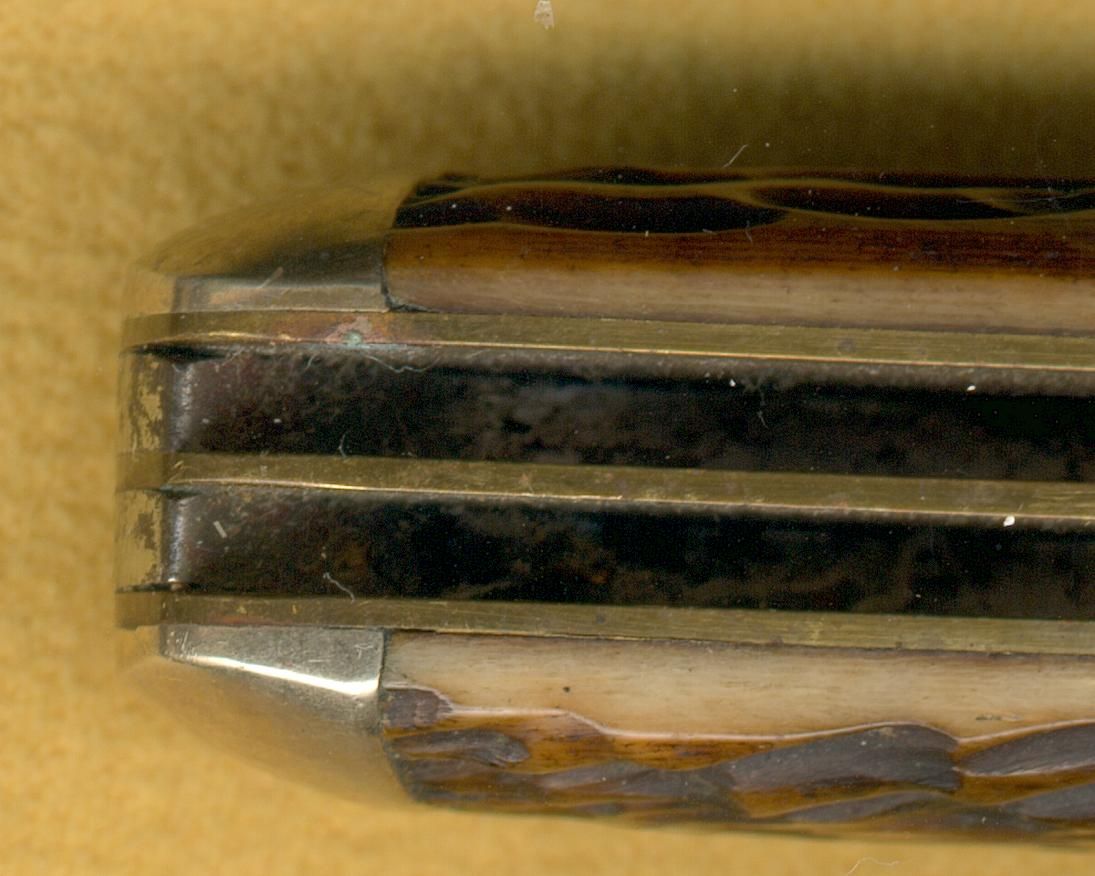

The close-up of the inside shows a trace of an insect exoskeleton, and some spiderweb (hard to see), and inspired the name of this thread!:rolleyes:

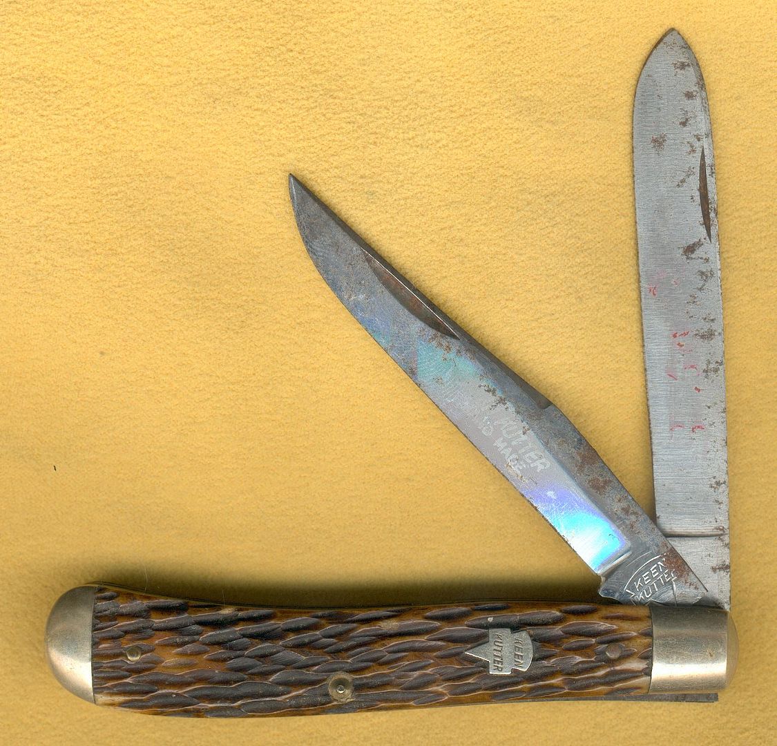

Upon close inspection, this knife looks like it never cut anything!! There are traces of red pencil or grease marker on one blade, but no scratches under twenty power!!

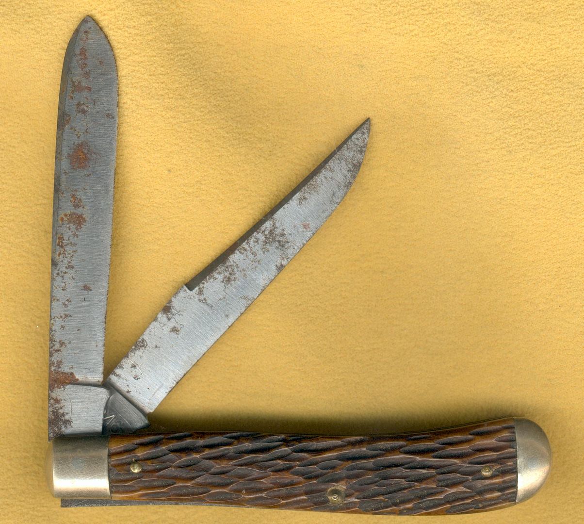

There are some light pits, and too much red rust though!!:grumpy:
I oiled the joint before I opened it, and now that I've scanned it, I am going to douse it liberally with mineral oil.
In typical fashion, the main blade was crocus polished on the mark side, and the Etch is clearly visible. The rest of the surfaces are glaze finished as you would expect, and the factory edges are there; but of course there is way too much corruption to let it be. At least I have to remove the rust.
We'll see what the oil, and some later brisk rubbing will do.
Stay Tuned!! But if anyone can help with suggestions that will preserve as much of the original finishes as possible, please chime in.

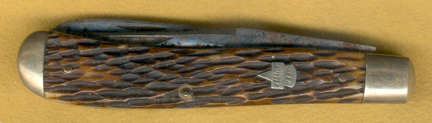

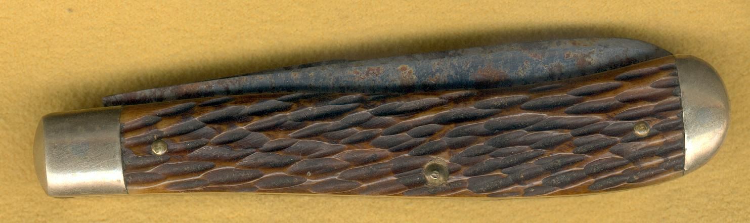

Jeez Charlie, that knife was never even carried by anyone. It was bought or given, stuck in a desk drawer, and maybe the desk got moved to the basement and the knife forgotten. The edges of the jigging are as sharp and crisp as the day they were put in there. No thumb ever stroked that handle. Never sharpened even. Entombed without having had a life.
I'd be very careful trying to remove the rust. Just bathe it in mineral oil and rub with a soft clean cloth. See how much comes off.
Gently son, gently.

I also think your interpretation is feasible. A desk drawer in a basement fits the condition.

Give it the mineral oil bath for a few hours and use a micro fiber cloth.0000 steel wool and the mineral oil will get the red out.An sos pad will turn the rust black.I think your done then.Keep it away from any brass,ns or bone. That looks marvelous.Can't wait to see the results.

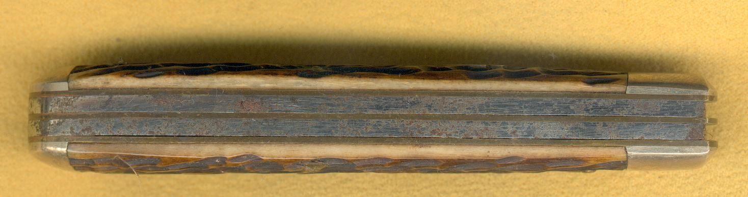

I had rust on the inners pretty bad with a antique shop find similar to use...I used a fine wet and dry sand paper folded to get inside and just lift it running back and forwards with oil dripped on the paper, then bathed it in clove oil for a week. It didnt change the colour of the bone and as I've been told by a few people it helps keep the bone from possibly cracking, i dunno if thats just a wives tale but i do that with all my bone, ivory and wood (even MOP, maybe i'm crossing the line). For the blades though I would just use a steel wool as stated, will take the red away and should just leave some pitting marks which will go black once in the oil.
That is a very nice folder, as stated a real diamond in the rough.
Looks like a keeper to me. A gentle wipe down with oil, maybe some OOO steel wool, and it will clean up nicely.

Charlie, please excuse my ignorance, but is this knife a Miller Bros Keen Kutter, or a Simmons Keen Kutter, or a Shapleigh Keen Kutter, or a Schrade Keen Kutter ?
my guess is Schrade, but whadaino ?
roland
It was made by Schrade, Roland. The DNA is unmistakable compared with the Schrade Waldens.
Shapleigh adopted the Keen Kutter brand after 1940, according to LG4, I guess from Simmons. Schrade made some/all of them after the War, until 1960 I believe.
After learning a few things lately and trying the mineral oil, I would just wipe down after the knife comes out and not do much more, the patina will not come out as I'm sure you know and the rust spots will blacken, the rust does not seem to be to far into the steel that I'm thinking they may just end up pretty much smooth. If not I have used a blunt matchstick to easily rub over the rust if it is slightly raised on the steel. Other than that I would think you could ruin the factory finish that still exits. Use a matchstick again to clean the inside while there is some mineral oil still inside the knife.

The ancient insect remains amid the old remnant of a spider's lair found inside lend the old girl a bit of gravitas: the tribulations of the food chain; nay! The very cycle of life and death was enacted untold years past within the dark recess of that handle! :eek: :D
