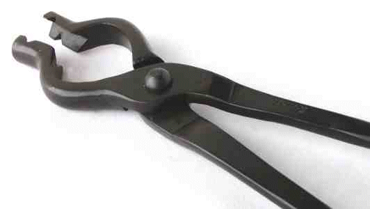

Mace,
I didn't make these Z-box tongs, but I bought a pair at Ashokan. They are great for holding bar stock. The off-center jaws allow the bar to extend up along the reins.
