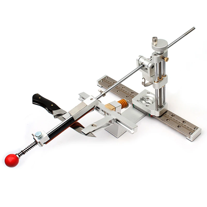

I received my toohr knife sharpener unfortunately the package was damaged and the guide rod was missing I contacted toohr for a replacement they really need to improve there packaging the parts are free to move around and damage each other and fall out.
One thing I noticed was the vertical rod bushes are a loose fit fortunately they are quite easy to remove and I have ordered some replacements from AliExpress will see if they are a tighter fit.
You could also ask them for a replacement for the bushings or the whole piece if it is that loose. Unfortunately sometimes the quality is a bit more miss that hit but overall seems to be quite good.

I received the bushings I ordered they fit perfectly

Has anyone had problems with the angle changing when rotating blade sides? Mine changes by about .5 to .8 degree after rotating and I have to adjust the angle each time I switch sides.
Do you mean the angle on the tower jumps down constantly every time you rotate it, or merely a difference of 0.5 degrees between sides?
If it's a difference between 2 sides of the rotating clamp unit, then I would advise against changing your angle every time. It's more consistent to only check and measure your angle on the same side of the blade every time you sharpen or switch stones. If the angle on the other side is within a degree or so, then it is better to ignore it completely and just stick to always measuring on the same side of the blade and rotating clamp assembly. This will give more consistent results.
That is exactly what I mean, the angle stays constant, it is just .5 to .8 different between each side. Thanks for the advice. I will try it

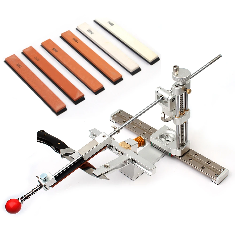

Okay. I read through this entire thread and am thinking on ordering one. Given the cheapness of ordering replacement “likely to go wrong” bits like the bushings, I figure I’ll just order them as well in case so I am not waiting for them.
1. There was a thread with a lot of options for bushings here: https://www.bladeforums.com/threads/toohr-3-knife-sharpener.1886171/page-12
If I am going to do it, which one is the best? The self-lubricating ones?
2. Basically plan on soaking everything with degreaser,
3. There were a couple of washers that need replacement? anyone know what size?
4. 777 Edge 777 Edge has designed a bunch of parts for it. But I saw some clamps were in and out of stock. I want to sharpen pocket knives, scissors, and kitchen knives, what do I need?
5. The stones are crap, correct? So assuming I want to go for mirror finishes, just buy Venevs and the rest?
Basically beyond the actual sharpener what should my shopping list look like?

Venev resin based diamond stones will serve you well, no doubt. You can get a pretty good mirror polish out of the fine grits already but if you want to go even further then get a strop with diamond compound like Gunny juice. Start with only 1 micron if you want to simplify it. Get yourself a nice storage case for the stones and strops.
The basic colored aluminum oxide stones that come with the TooHR is junk. Just throw those away. If you get diamond plated stones with your TooHR, keep them - those are great.
As for the TooHR, I wouldn't buy any extra parts just yet. Most of these are just fine and not in need of replacement parts. If your bearings are gritty, just give them a clean out.
As for a set of clamps, get the Hapstone Standard angled clamps. They will do most of what you need. Be sure to order the Gearconnect adapters with them and ask for longer bolts from Gritomatic. Tell them it's for the TooHR when you order them.
For scissors and any other weird shaped or difficult knives, get the Leading Edge core upgrade. It has a scissors clamp, and the magnetic platform is very versatile on any of those difficult-to-clamp knives.
Here are some links for you:
Thanks. That is awesome. Now to figure out which ones come with the diamond plates. The one I have in my Ali cart is no whetstones. But might as well find the right one.
This one has the wrong stones, right?
Correct, those stones are complete junk. The diamond plates are silver in color.
