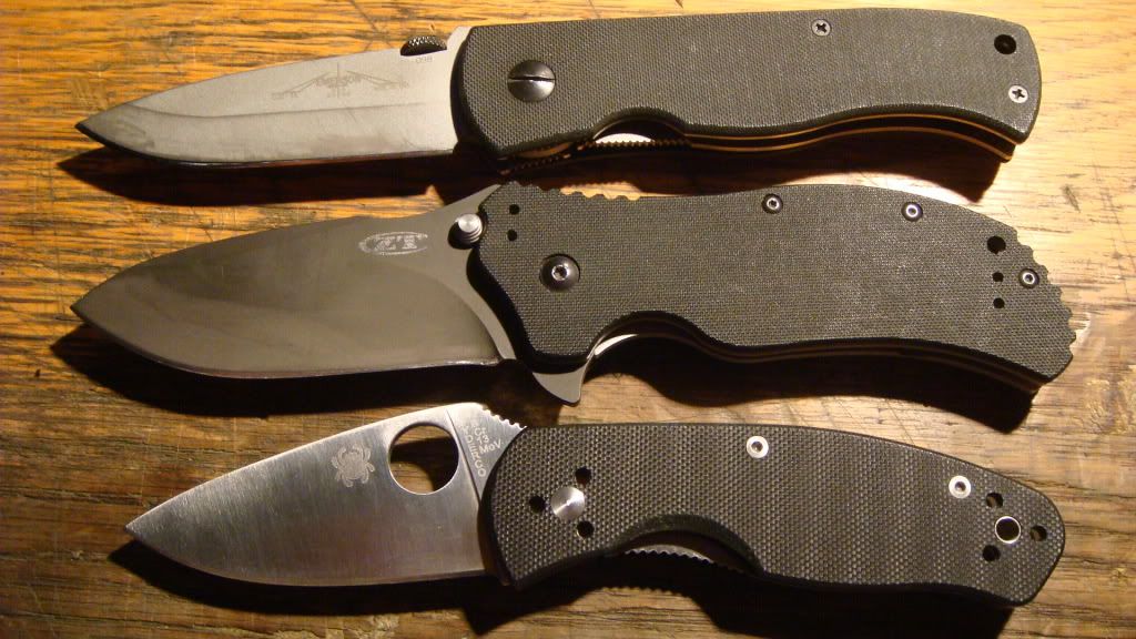

I also feel there is a in between edge. A semi polished lightly toothed utility edge which is what I find I use most on the job. Enough tooth to grab onto nylon banding and rip through it but honed enough that the blade slices through heavy corrugated. I am no metal expert, but I am sure that each different steel has properties that are better suited to a specific grind and or hone style for max performance. Just my two cents. Great topic though!:thumbup: I enjoyed this thread very much!

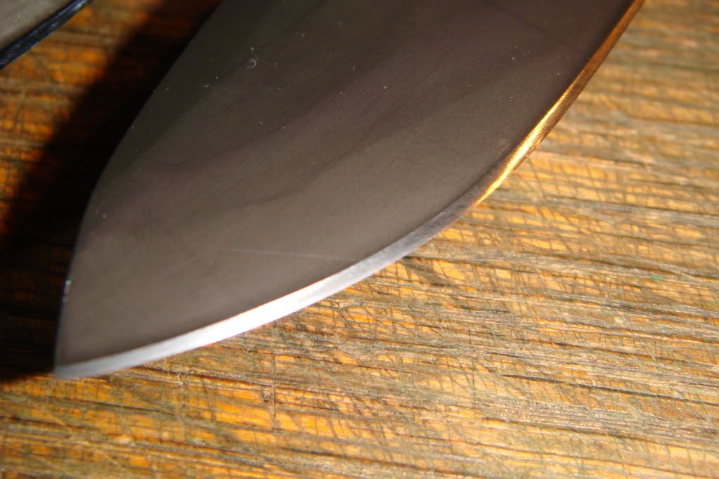

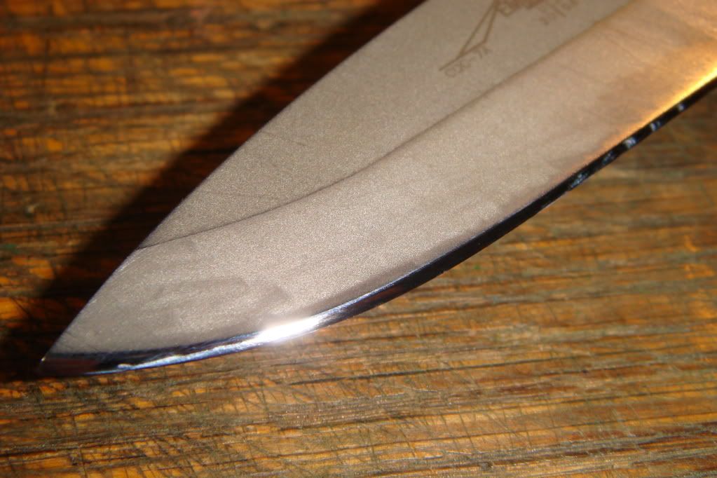

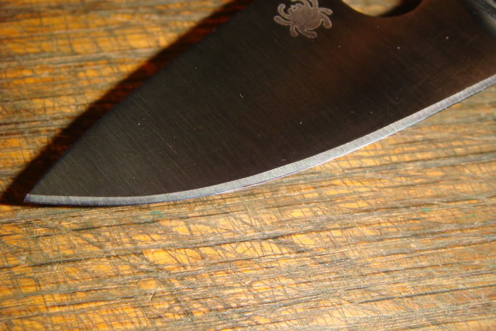

Three different knives and steels with different edges.
ZT 0350 S30V with utilty edge. Lightly polished.
EKI 7A CM 154 with a work in progress highly polished edge.
Spyderco Persistence 8Cr13MoV Factory edge and a hard week of use.
All are hair shaving sharp with different blade geometry and materials and uses. It's what works for each knife for me...;)
