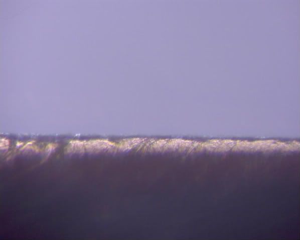

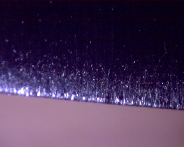

Factory edge:
Sharpened edge:
Damaged edge:
I'd rather start with the one that looks sharp ;)
