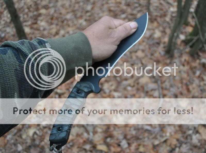

Some in hand shots in various grips.
The knife came with a very sharp edge, and I found it easy to control when whittling.

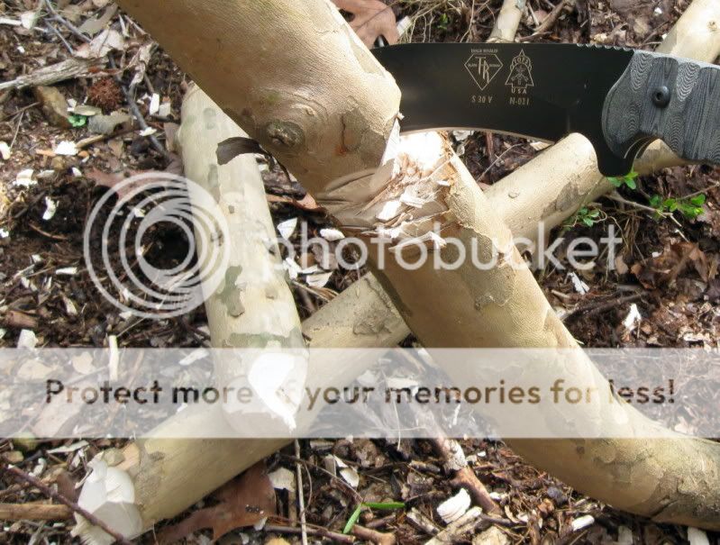

Later I used the knife to chop a hard seasoned sycamore limb into manageable pieces, and then used a baton to split some kindling
end part 4 of 5
You can see that the coating is finally starting to wear, but even the area of the blade that has had the most wear is still sharp enough to whittle some nice curls. The S30V is showing itself to be very durable and holding a good edge.

Definitely liking the results so far. That bent sycamore was hard and it put the blade in a bind so it wasn't just splitting it like a wedge. The edge was in contact most of the way through the split on three fairly large pieces. I see no ill effects on anything other than the coating. The size is great for me. It gives me plenty of length and weight to lop briers and limbs in the thicker scrub without being overly large plus is thick enough to handle some rough work as well. And yes I have fat fingers too and the choil works great for me.
