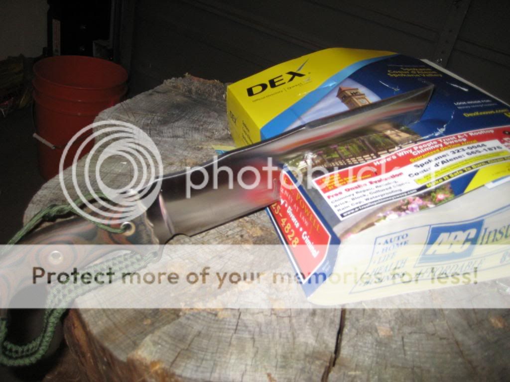

New (Skunk's company store pic... but I did buy the demo FFBM in this combo :D )
Stripping it with some Klean-Strip KS-3 Stripper...
Stripped and washed off with soap & water...
You'll probably find some infi dimples & rough grind marks...
Cleaned up a little with some 220 grit sand paper...

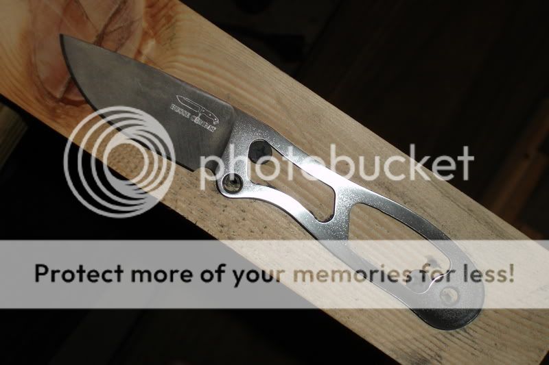

Foo, did you hit that stripped Skelly with a Scotch Brite or anything?
While we're asking, I'd like an XXXL Nick. :p
I locked it down to a 2x4 with some drywall screws
and wrapped a sheet of 220 grit around a 2x2 and used it like a file to sand the flats.
Used a small piece of 220 with my thumb and cleaned up the spine and blade surface.
