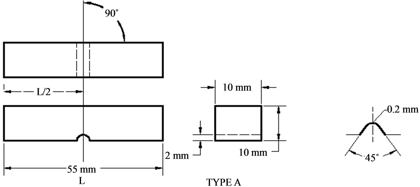

Another problem with C-notch is that knives are not designed like blocks of steel. They thin out and the crystal structure in a HT'd knife will behave differently in a knife shape than a rectangular block. S30V may well perform as stated in square block shape and it may be a total failure when thinned out. Just saying this is a possibility as well.
This is not representative of a thin edged knife.

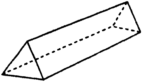

Maybe the knife industry should have a different c-notch testing sample that looks more like this
