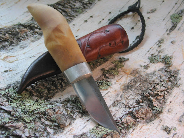

I have a friend who did just that. He's a woodworker by trade, and makes puukkos in his spare time.
This puukko was made to be a compact, yet sturdy, "workshop knife".
It started out flat, but is hollow in the new picture. This is because I soon noticed that I had, by pure chance, nailed the heat treat on this one, meaning that the blade could easily hold a hollow grind, which I prefer.
