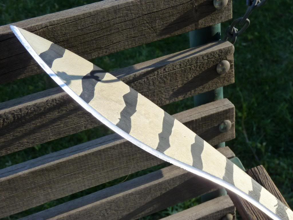

Small hard branches are murder to thinly ground edges.
https://youtu.be/q8hyfbcSJ18
I have learned now in this thread a thinned edge against small twigs is no good! The video was eye opening, a machete chips out with just small branches.
So........if an axe would also be no good, what would be the best tool for small branches? I'm thinking now a saw or pruning shears would be good for the backpacks. Takes a lot more time though than just whacking a tree with a machete.
Also, would it be better to have a machete with a larger secondary bevel? I reground a cs machete to have a steeper angle and it seems to help:
I delimb with lots of things. The most a Junglas, Esee 6, TGLB, and a SOG Seal team. No chipping at all. Seems a thicker blade or a better steal or a more obtuse edge might be better? Some comb or all three?
The steeper the secondary bevel the more material you remove and technically it's weaker. On a blade like that with that bevel it's screaming to be convexed. It will cut better and be stronger . I have the same machete as in the pic , also regrouND mine. IIRC it's 1055 steel (probably wrong on that).
It's my dedicated limb chopper for my fire pit. Few times I've went right through branches and onto our little Brick wall we have outside and the blade hasn't chipped on me yet. Those machetes are pretty strong for the money
