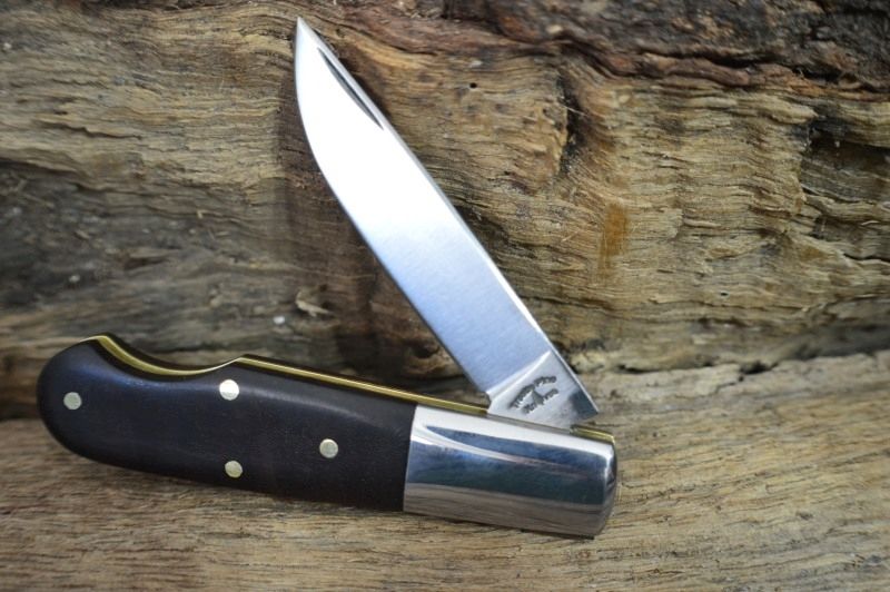

It looks similar to the blade on their "Country Cousin" sodbusters (except the nail nick is further forward). I think a spear may be a better match with the easy open notch because it would leave more room for sharpening. I think that may be why they needed to tilt the blade in the barlow. The sodbuster handle curves on the end.
Not to split hairs, but I'd not call that an EZ open notch. Were that the purpose it'd be deeper. That area is relieved because it's necessary to access the nail nick. Without it the nail nick would be below the liners.
Can we compromise and call it "easy relief"? ;) :D

I think that all of these oddities are why I find this knife so intriguing. Greg and Queen aren't afraid to throw convention aside and try things that seem a bit odd in an attempt to come up with the perfect user. The Superior is also an odd looking knife, but I've heard a lot of positives from people that have handled them. Some might call it reinventing the wheel. I choose to see it as thinking outside of the box. Either way, I think it's a fun line of knives that are very unique and I applaud them for their efforts.

You're right, it's not really an easy-open notch. But the "relief notch" is only necessary because the blade angles down into the handle the way it does, and I think that the sloping angle of the blade when closed is what I like least about this knife. It looks like someone was trying to file the kick down on a knife with a proud tip and went way too far. I'm also curious how much clearance there is between the edge and the backspring when closed, and if there are any issues with the edge hitting the spring. Seems like it would be awful close quarters in there.

That skinner just looks too wonky to me. It'd be fine (minus the nick placement) on a trapper or sodbuster, but it just doesn't look right on this frame.
I'm with Cory on this one, several aspects of the knife are unique, but intended for a practical purpose. It gives the Portage a difference in appearance that make it instantly recognizable as a Trestle Pine product. The size makes it a smooth, easy carry, and, at least on my example, the notch does make it possible to pinch open. The blade shape and size seem to make it useful for most of the tasks we call on our pocketknives to do, yet not so big as to be intrusive in the pocket. And finally, for me at least (and all opinions can vary on this) I like the lack of advertising or message shouting from the blade. Simple and sweet.

A relieved area is typically at an angle. The covers aren't typically ground straight down with the liner. The blade does look like it can be pinched open but someone who owns the knife would need to confirm. If the blade was a typical spear with a curved spine, then it wouldn't need to be angled down and there would be much more room to pinch the blade open. The notch wouldn't necessarily need to be bigger.

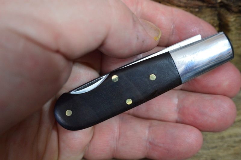

Pinch open? Yes

As for the EO cut out or "easy relief " I would say that this was not an addition thrown in just to be different but instead is placed to be a functional part of the knife. Yes this blade can be pinched open but I feel like that wasn't the intention. It can be done, but with medium to large fingers it becomes a pinch with the very tip of your finger and thumb. Although the cut out is shallow and may look odd with the nail nick that far down the blade these were both positioned to make it nice and easy to open. These features combined with a lighter pull puts it on the opposite end of a nail breaker.
Tip exposure from the EO cut out-
In my opinion there is a good deal more room then it appears in pictures to sharpen the knife before the tip becomes exposed in the notch. With some serious use and a lot of sharpening you could get to that point but by then I think you could do some interesting things re shaping.

it is definitely a tight fit inside the liners and I did the best I could with a small light to try and estimate the clearance of the closed blade to the back spring. From what I can see the clearance is minimal but there are no indications anywhere I can see that the blade is resting on or hitting the spring. So long as this is the case the clearance should only increase with more sharpening.
Profile in pocket-
The knife shares many similarities to the #25 in a drop point. Although the spine sticks up and then angles into the liner it's not noticeable in a negative way and is far less than pictures would lead one to believe.The thin profile of the knife and OAL really make it disappear in the pocket. If you weren't checking closely you might think you'd lost it.
